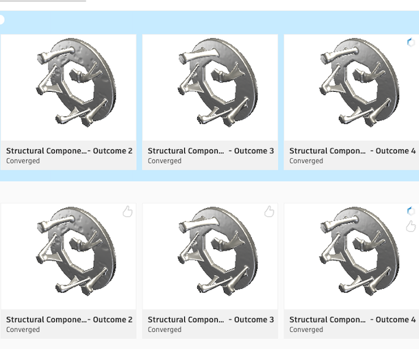

  3. Trying generative design on the frames and wheels. Although I am not confident that it will reduce the weight significantly, I am very interested to see the new aesthetic it may generate on my car.
