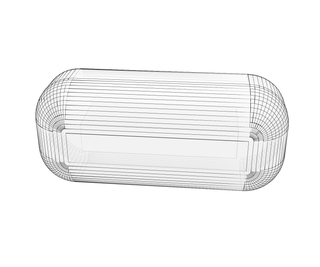

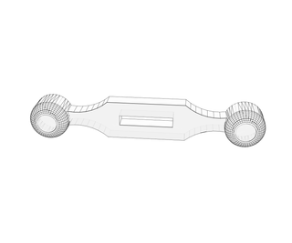

The blade of the sword is made from a home depot yard stick (paint department $.98), I added a layer of chrome paint for flourish. The handle is wrapped with hockey tape for a better grip and look. The Cross-guard and Pommel were 3D printed using PLA.
Begin by printing the Cross-guard and Pommel. I used a low resolution setting with 3 shells and 20% infill, this gave me a solid part that can take some abuse from the kids (me). The parts I designed are specific to the yard stick that I purchased, you may need to scale the parts a bit to get a nice fit.
I designed the parts for a tight press fit, this way the handle stays together without adhesive.

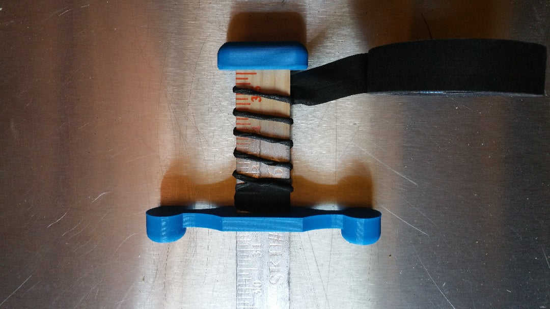

The plastic printed parts are designed to be pressed into place, using an exacto knife I beveled the back edges of the blade slightly to help them start into the Cross-guard and Pommel. Be careful using the razor blade my efforts earned me two stitches, and mild disapproval from my wife.
If the blade seems loose, a bit of two part epoxy would be a fine addition.
Step 4: Wrapping the Handle
The handle was wrapped using hockey tape.
  • Start by attaching the tape to one end of the handle and unrolling it 12-18".
  • Hold the sword in the air with the tape roll hanging below, spin the roll until the tape twists into a thick string.
  • Then wrap the twisted part of the tape around the handle with 1/4"spaces in between.
  • When you reach the other end of the handle you should run out of twisted tape.
  • Cover the twists with a single layer of tape to finish the look.
