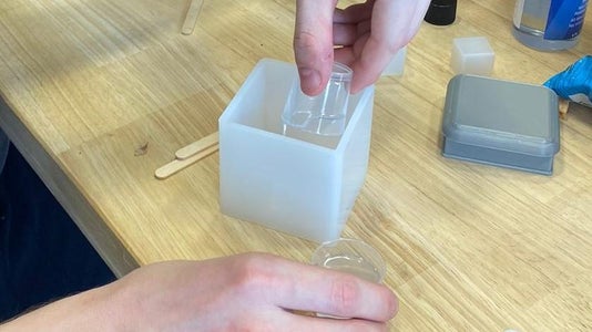

Step 6: Resin Curing Option
For hard to print parts, resin curing can be used instead. To resin cure, a silicon mold is needed. We started by mixing a small amount of part A and B of the resin in a 1:1 ratio for 5 minutes. After letting the resin sit for 20 minutes, the air bubbles were removed. A small layer is poured and left to cure for 20 minutes. While the initial layer is curing, another batch of resin is mixed and left to sit for 20 minutes to remove air bubbles. Once the initial layer is gel-like, the part can be pressed into place, and the second batch of resin can be poured over it until the part is fully submerged. Air bubbles can be removed by using a lighter on the surface of the resin or a toothpick. After the resin cures for 25 hours, it can be de-molded and modified.

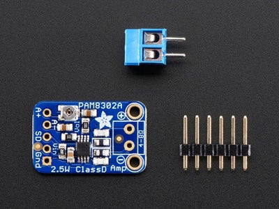

Step 10: Add Speakers
Place the supplementary amplifier chip onto the central breadboard. From the electronic soundboard, connect either the R or L output pin to the amplifier chip's input pin (A+). Connect the other input pin (A-) to ground. Connect ground (Gnd) to ground. Connect the speaker wires to the chip's output holes and use a screwdriver to secure the connection.
When a button is pressed, the sound should now emit from the speakers.
