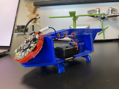

Step 3: Assemble
- Remove supports using cuticle cutters
- Sauter wires onto CPX
- One wire should be sautered to VOUT
- One wire soldered to A1
- Third wire soldered to GND next to A1
- Place the CPX mount on the front of the helicopter face
- Hot glue on foundation
- Once dry place CPX in mount
- Place the servo motor mount…
- Once dry place motor in mount
- Connect brown servo wire to GND
- Connect red servo wire to VOUT
- Connect yellow servo wire to A1
- Place 3 AAA batteries into battery pack
- Glue the battery pack next to the servo motor
- Glue tail, rear rotor blades and legs onto the helicopter
