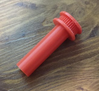

The most delicate part of the design was the shafts. For the profile of the gears on the shafts I used the GT2 pulley generator web page where I generated a profile for a standard GT2 gear with 36 teeth with a different inside bore diameter depending on the axis (4.2 mm, 8.2 mm, 12.2 mm). Why exactly 36 teeth? Because I will eventually use this adapter to build a clock. Of course, the number of teeth can change depending on the application. The most common stepper motors have a step of 1.8 degrees, which means 200 steps per rotation. I wanted to have a number of steps divisible by 60 so that the number of steps would make an integer. So I mounted a 20-tooth GT2 gear on the stepper motor shaft. Three belts transmit the rotational motion of the motor to the shafts (on which is the pinion with 36 teeth), the number of steps becomes 360/(20/36*1.8) = 360 steps per revolution, so one second would mean rotating the motor shaft by 360/60 = 6 steps.
Another important value of the mechanism is the distance between the axes of the two pinions, the one on the motor with 20 teeth and the one on the axis with 36 teeth. To calculate this distance I used the Timing Pulley Distance Calculator web page Since I used 3 188mm long GT2 belts it resulted in a distance of 69.297mm. However, it must be taken into account that I also needed a little clearance to facilitate the installation, so on the motor supports I made 4 small channels, not just simple 3mm holes..

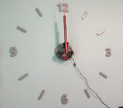

After I assembled everything (see also the electronic part in the next step), I asked myself how can I fix all the mechanism on the wall to make the clock. For this, I designed an intermediate plate, which is fixed in the wall, either with screws, with the help of holes, or as I tried the first time, with the help of pieces of double-adhesive tape that did not hold. So in the end it's all down to the screws :)
...files on Tinkercad...
I haven't printed the cover from the page, but whoever wants to finalize the watch can use it.
I fixed the mechanism to this plate with the help of three M5 screws, nuts and washers and dome risers. I also mounted the clock hands.
I have attached some photos about these operations.

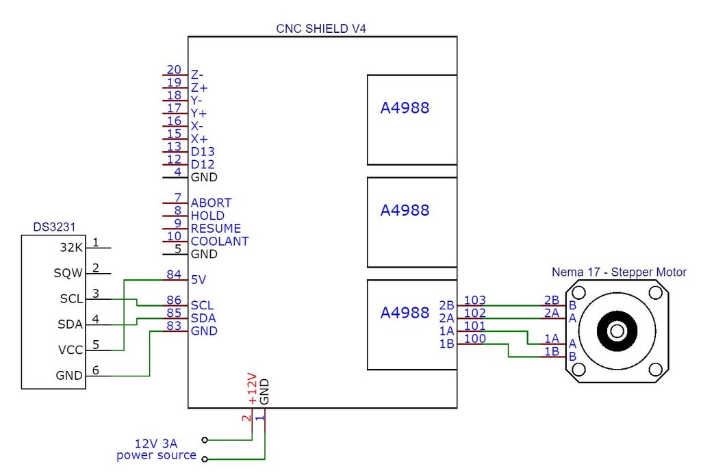

The schematics is below
As you can see, I just made some quick connections: with Dupont wires between the RTC module and the CNC shield and with cables between the motors and the CNC shield, you can see in the photos above how it looks.
Some clarifications...
Because the RTC module came without a battery, I used a CR2032, but it is not rechargeable. The module instead needs a LIR2032 (rechargeable), I didn't have one and so I had to disable the battery charging circuit, that is, I broke a connection on the PCB, the connection between R5 and D2 as in the picture below.
More in this post on the Arduino forum DS3231 CR2032 vs LIR2032 warning! Is your module killing the battery?
Even the CNC shield is not perfect, I bet you know 🙂 , but for what I wanted to do with it, no modification was needed (for example, activating the micro-stepping). I have to admit, however, that I made the changes in the article just to see how the watch behaves when using the micro-stepping, I tried with 1/2 and 1/4 steps but in the end I used the full step.

It is also necessary to adjust the reference voltage, after which the maximum current that will pass through the motors is determined. I adjusted the vref of each a4988 driver to the value of 0.64 volts which corresponds to a maximum current of 0.8A on each motor (0.64x1.25) More here: How to set VRef for A4988 and DRV8825 stepper motor drivers.
For the power supply, it turned out that a 12V 36W power supply would be enough - according to this article: How to choose a power supply for my stepper motor?
I also had an unpleasant surprise during the tests... The motors didn't want to work properly, they were spinning wildly, humming, stopping and starting again... I didn't understand why. In the end, I realized that the wires from the connection cables between the CNC shield and the motors have two wires reversed at the plug on the motor side. I arranged them correctly and everything worked perfectly afterwards.

The manual homing is nothing but the manual rotation of the clock hands at 12 o'clock, and then I would consider this positioning to be the home of all motor movements when starting the clock program (see photo)
When the program actually starts, the time is read from the real-time clock, the motors rotate the hands in the positions corresponding to the time read, then all the hands of the clock move with the passage of time. The second hand rotates every second to the position second*6 steps, the minute hand moves one step every 10 seconds and the hour hand moves every 2 minutes one step...
After a power drop, this manual homing must of course be redone, otherwise the clock will start from a random position. Luckily, after homing, reading the exact time won't be a problem, it's just saved in the RTC module, isn't it? 🙂
