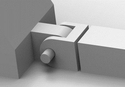

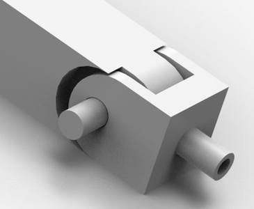

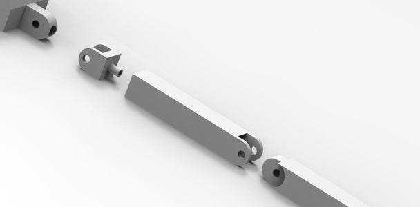

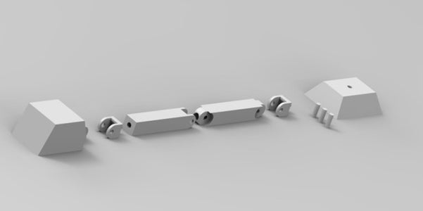

Step 1: Creating the 3D Model
To start the 3D modeling process i would recommend first drawing a full scale mock up of the size you want your final product to be as then it become easier to model the final product as you can see exactly the final size.i Started off my creating the base then working my way along taking additional care on the hinged sections. Between the hinge and the support beam i left a 3mm gap each time as washers were placed in later. I create the pins so that they fit in with a pressure fit to hold each section securely in place. I would recommend a 3cm by 3cm square face for the support tubes and then an extrusion of any desired length however going above 30cm in length would not be recommendable with this tube thickness.. After modeling each section i would recommend dragging all the parts together as shown in the images above so you can see how the fit together and if any sizes need adjusting and amending. i would recommend a tube of at least 8mm boring through the center of the tubes so that it is enough to house the cables for the internal cable routing.
