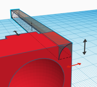

Step 4: Designing the Second Vent Clip - Part 3
This step is optional; doing it will make this piece less sharp and therefore easier to handle. Go to the shapes menu and find shape generators and then click all. Scroll to page 12 (usually) and create the shape called "metafillet" as a hole. Change its horizontal dimensions to 5 mm by 5 mm and extend its height extremely. Next, rotate this shape by 90 degrees. Then, align it to the top right corner of the piece from the last step. Once you have done that, duplicate the metafillet and use the flip tool to reflect it the other way. After that, align it with the top left corner and group the three shapes. You are done designing this piece!
