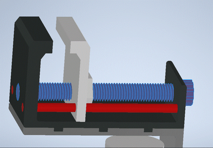

Step 1: A Totally Skippable Working Principle
Clamps and bench vices are an essential tool in any hobbyist workshop as they can help them to hold objects firmly while working. The working principle behind these tools is similar to a simple nut and bolt. As, In the attached GIF file the black part is the casing of the bench vice, whereas the blue part is our bolt/screw, and the grey part is our nut AKA the moving part. So, when the screw rotates, our nut can move in a linear direction with the help of helical threads. We cannot push the nut with our hands because threads won't allow this motion, as shown in the photo. Based on this simple mechanism, we will design and build our clamp-vice.

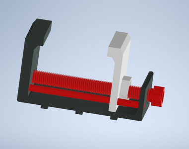

Step 2: Design
In this section, we will talk about the design of our clamp and vice. So, first, let's talk about the clamp.
  • Clamp:
As shown in the picture (left), the clamp is 125mm in length and 60mm in width with a clamping length of 40mm. It also has three grooves on its flat surface so that we can fit anything onto it. I have also added some slots in between the grooves to reduce material wastage. We have a circular plate and screw at the bottom, and when the screw rotates anticlockwise, the circular plate rises upward and holds the object firmly.
  • Vice:
The dimension of the vice is similar to the Clamp, but it can hold any object up to a length of 77mm. It also has three reverse grooves so that it can fit onto the clamp. Similar to the clamp, when the screw rotates, then the jaw of the vice moves linearly to grab the object. Moreover, I have added two supporting rods to support this motion.
Notes
  • Dimension of grooves and reverse grooves is crucial because if the clearance is not appropriate, then they won't fit perfectly, and we don't want a loose fit. To solve this problem, I gave 0.2mm clearance, therefore, the grooves on the clamp have a width of 7mm, whereas the width of reverse grooves in the vice is 6.8mm.
  • The same goes with our supporting rods, and in that case, I have given 0.3mm clearance.
