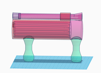

I'll be showing you how to make a 3D printed water shooter - I won't be going into detail on design (here's the TinkerCAD project in case anyone does want to know how it was put together though) - it works similarly to those pool noodle water sprayer thingies only this is obviously printed - it's almost like a huge syringe!

I've popped the 3 stls you'll need below - you'll want 1 each of parts A and B, 1 cap and 2 handles :)

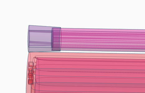

  1. Take parts A and B and slot B into A, passing the protruding part of Part B through the cylinder shaped attachment on Part A
  2. Once you're happy that Parts A and B are fitting together well and that they can move smoothly take the cap and glue it in place on the end of the protruding piece of Part B - this will hold everything together and stop Parts A and B from coming apart when refilling
  3. When everything is fitting together nicely, you just need to take the handles and glue them in place - there's an oval indent in both Part A and Part B that they should slot into quite nicely
