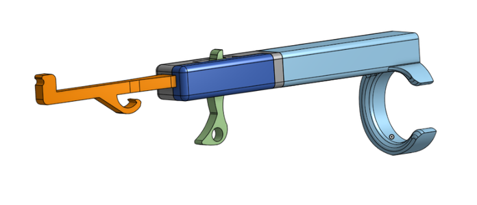

My project is assembled with 5 parts.

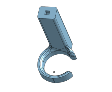

Part 1 (Light Blue) is basically the base of my entire project. It has a circular rest with enough space to fit my hand and write through. On the top side, I cut out the edge of the 10 mm cube with my switchblade in order to insert a 10 mm cube into a 10 mm cubed hole from another part to make it easier to assemble.

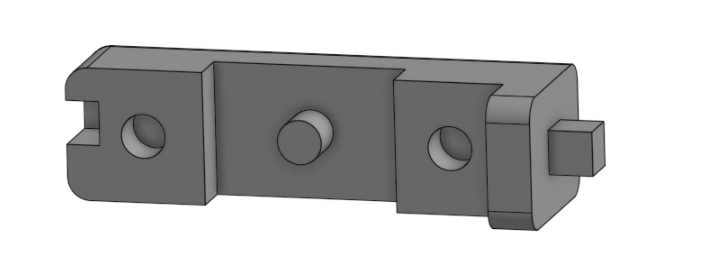

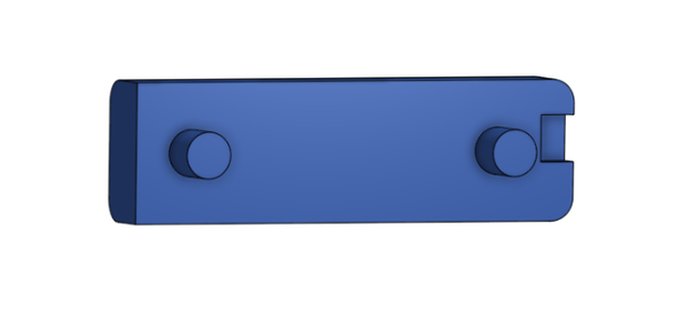

Parts 2 (Gray) and 3 (Blue) share a very similar design. But unlike part 3, part 2 has a 10 mm cube extruded from it to connect to part 1. Both parts 2 and 3 are designed as a shell for part 4 (Green). As shown in the photo, part 2 (Gray) has its own cylinder-shaped extrusion while part 3 doesn't. This cylinder fits through the hole from part 4 (Green).

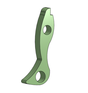

Part 4 (Green) is the trigger of the wrist shooter and has two holes. The hole at the top fits perfectly with the cylinder-shaped extrusion from part 2. The hole at the bottom is where rubber bands will be wrapped to be used as a "trigger resistor" for the wrist shooter. The top of the trigger is where the rubber band will be loaded. The loaded rubber bands will be stretched to Part 5 (Orange)
*Trigger resistor - When a rubber band is stretched and hooked onto Part 5 (orange), every time someone pulls the trigger, the rubber bands attached to the trigger resistor will pull the trigger back to its original place so that it can be pulled again.

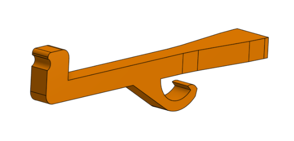

Part 5 (Orange) is an extension to stretch the loaded rubber band even further. I included a hook at the bottom of the part to hang the rubber band that is stretched from the trigger resistor. In order for the shooter to be loaded with a rubber band, I designed a slit at the end of part 5 for the rubber band coming from the top of the trigger to stretch to.

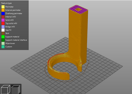

- Once all the STL files are downloaded, I opened up PrusaSlicer (you should use the slicer suited for your printer).
- Once I got my slicer open, I added my STL files and arranged them in such a way that the print would have the lowest chance of failure.
- I sliced the 3D models with a 30% infill. When I tried printing my models at 20% infill, there were many times where smaller parts of my model would break apart. So to make it stronger, I had to increase its density.
- I also enabled supports (touching build plate) since Parts 2, 3, and 5 have overhangs.
- Then I started printing on the Prusa Mini + with PLA filament (filament I used)

1. To assemble all 5 parts of the wrist shooter, I connected the cylinder-shaped hole in the middle of part 4 with another cylinder-shaped extrusion from part 2.
2. Once part 4 was connected to part 2, I connected it to part 3 using the two cylinder-shaped holes I made on part 2.
3. Next, (while assembled) I connected part 2 to part 1 using the 10 mm cube-shaped connection points I made.
4. Once parts 1 to 4 are all assembled, I used the hole made from parts 2 & 3 to connect to the extrusion from part 5.
5. Now that all 5 parts are assembled, to make the trigger resistor, I tied the rubber band to the bottom hole of part 4 and stretched it to the hook from part 5.
