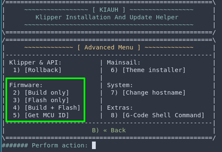

  7. KIAUTH from th33xitus (Optional) KIAUTH is a fantastic app that installs Klipper, Moonraker and Mainsail with a click of a mouse. You can do all of this yourself but why would you? - FREE

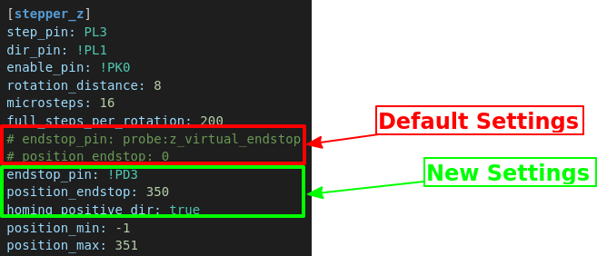

Step 1: Replace Z Homing Sensor With Mechanical Endstop Switch (Optional)
The Creality CR10s Pro V2 comes with a BL-Touch style sensor for Z axis homing. For the watch cleaning machine, the Z axis home needs to be at the top of the gantry and not the build plate. The mechanical endstop switch is plugged into the Z- socket on the board. Below is the update to the klipper config file that reverses the Z axis homing position and uses the mechanical endstop switch.
[stepper_z]
step_pin: PL3
dir_pin: !PL1
enable_pin: !PK0
rotation_distance: 8
microsteps: 16
full_steps_per_rotation: 200
# endstop_pin: probe:z_virtual_endstop
# position_endstop: 0
endstop_pin: !PD3 # was probe:z_virtual_endstop
position_endstop: 350 # Was 0 but needs to be the top of the gantry
homing_positive_dir: true # Home away from zero (ie towards the top of the gantry)
position_min: -1
position_max: 351

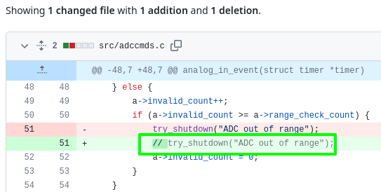

Step 4: Edit Klipper to Avoid "ADC Out of Range" Error
Now that the hotend assembly is removed, Klipper reports an "ADC out of range error" as it expects to get readings back from the now removed hotend thermistor. This is a simple code change to the adccmds.c file. Find the line that reads:
try_shutdown("ADC out of range");
Add // in front of the word "try" and save. The line should now be:
//try_shutdown("ADC out of range");
You will now have to recompile Klipper and flash it to your printer. This step can differ depending on the printer used but you can use the recommended app, KIAUTH, to make this step simpler or follow the Klipper instructions

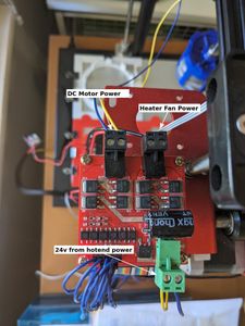

Step 5: Mount the Motor Driver
I used the structs that mounted the extruder to mount the 24v motor driver. The power for the driver came from the 24v power for the hotend. The driver is used to control the DC motor and the fan for the PTC heater. This driver was attached to a 3D printed mount and then screwed on to the structs

Step 8: Connect the PTC Heater
This is the step that took me longest to figure out. I wanted to use existing the 24v power supply for the heater bed so I snipped the wires and connected the PTC heater. I thought I could just issue the M140 - Set Bed Temperature gcode command and the power would then drive the PTC heater. However, for safety reasons, Klipper expects the bed to heat at a certain rate and because I don't have a heater bed and thermistor, Klipper would shut the PTC heater down after about 10 seconds. I tried editing the Klipper code but the result was the same.
I then found that if I could send 5v to the MOSFET that controlled the heater bed I could bypass the motherboard and the errors. A Raspberry Pi only outputs 3.3v on it's GPIO so I couldn't use those but I could use the 5v supply from RPi. I then rigged up a 2N2222A NPN Transistor that would allow the 5v to flow from the RPi to the heater bed MOSFET when 3.3v is applied to the transistor gate.
I did contemplate using a hairdryer or some other externally powered device but I really wanted to keep everything contained to the printer and RPi

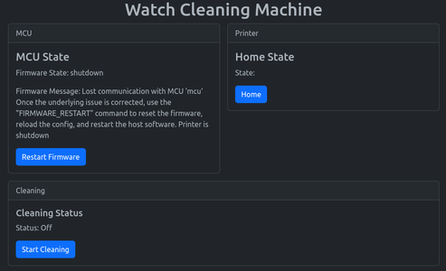

Step 10: Code to Control the Cleaning Process
To control the printer, motor and PTC heater I created a Pyton Flask application. The code controlls the motor and PTC heater via the RPi GPIOs and the printer itself on controlled via calls to the Moonraker API.
Although I'm a software developer, this is my first app written in Python and I know it could be improved. The template is meant to updated with a status indicating the current clean/rinse/dry cycle but I haven't completed that bit and honestly it's a nice to have that I probably won't get to. The code can be found here
