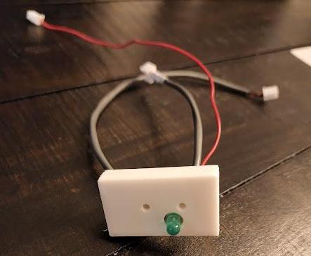

Step 1: Assembling the Laser
Start by carefully applying thermal paste to the sides of the laser diode and inserting it into the diode enclosure. Be very careful not to get the paste, which is conductive, on the pins or on the face of the diode. With the diode lightly in place screw on the back of the enclosure carefully, but firmly, to press the diode into place. I made small turns and took the back off to make sure the diode was being pressed in evenly and repeated until it was fully seated. Once installed I soldered on wires, put heat shrink over the pins and wire, pulled the wire out the back of the enclosure, and added a JST SM connector.
With the diode in the enclosure it's time to wire the rest of the circuit. I used JST SM connectors on both input and output of the 1.25A Diode Driver. The input of the Diode Driver gets it's positive leg with a 2A fuse in-line from the Buck Converter and the negative leg from the negative fan pin using a JST HX connector. I installed the reverse polarity protection schottky diode here with the bar towards the controller. The Buck Converter gets its input from the 24V power supply with the output dialed to 8.6V.
Since my Creality 4.2.2 board only had 1 controllable fan port, I cut the part cooling fan wires and used the JST SM connectors to make a connection to the fan ground at the print head. I swapped the connector back and forth between the part cooling fan and the laser. On my SKR 2 board I used the 3rd fan port (FAN2) and have a dedicated connection for the laser.
NOTE: The reverse polarity schottky is not necessary on Creality boards as the fan negative pin connects only to ground through the onboard mosfet. SKR boards have a indicator LED on the fan connector that can leak reverse current to the laser driver while turned off.
