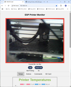

Real time image stream of the printer.

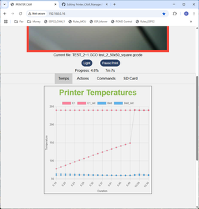

Real time Bed and extruder temperatures.

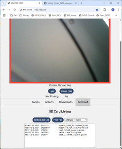

SD Card support, reading and SD file printing.

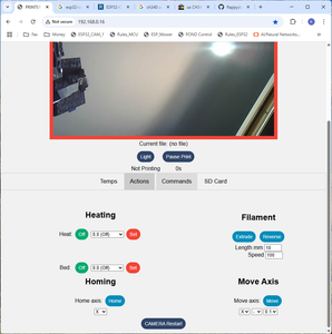

A Action panel having various controls for the management of the printer.

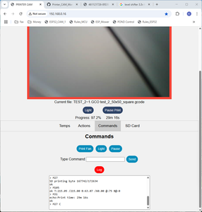

A Command panel to provide the operator full command capability and logging of all data (both rx and tx) of the printer interface.

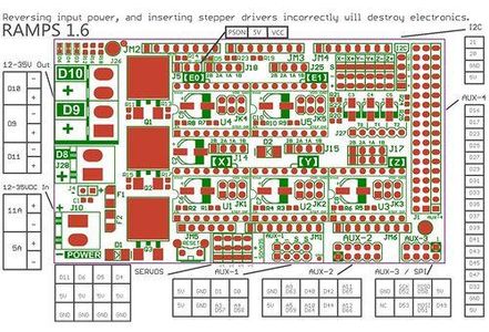

The coms interface is available from the ramps board on a the aux-1 pins, see diagram and breakout
5v,Gnd,D1 (tx) ,D0 (rx).
Make up a cable and connect to your board.

Check temps page and you should start seeing temperature readings.
On the SD page. If a SD card is fitted you can, after a small delay, list the files.
On the action page you can manipulate the printer with a series of common actions.
The command page allows you to send adhoc command the Marlin software. It also provides a log of all messages to and from the printer by pressing theLog button.
I am hoping now this basic interface has shown it is possible to use the ESP32-CAM simulatiously have a video stream as well as having the ability to manage the printer. The cost is now only a few pounds rather than buying raspberry pi etc.
