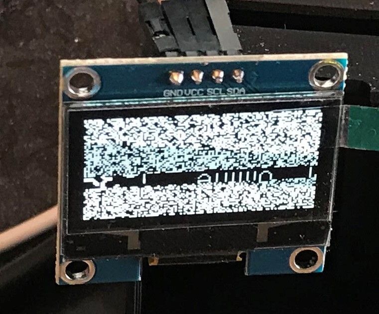

Step 1: Solder Up the Wemos D1 Mini With the 128x64 I2C OLED Display
This step only requires connecting 4 wires between the Wemos D1 Mini and the OLED display.
- SDA -> D2
- SCL -> D5
- VCC -> 5V+
- GND -> GND-

Fit your Wemos and OLED in the case. You may need to apply some glue to the outer corners of the OLED display to get it to stick into the case. The Wemos will be held into the case by the back panel.
