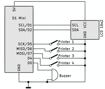

The front panel has room for a standard 16x2 I2C LCD and 4 holes for 4 tumbler switches. Every printer has one switch and you can use up to 4 switches. You can use brass threaded inserts with M2.5 bolts to tighten the front and back panel.
Prepare the electronics (LCD and switches) according to the schematic. Use as many tumbler switches as you have printers. Wire the LCD's SDA to D2 of the D1 Mini and the LCD's SCL pen to the D1 of the D1 Mini.

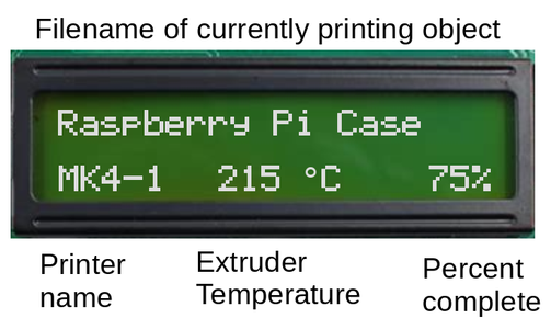

Use the tumbler switches to set which printers you want to monitor. You can monitor up to 4 printers at the same time. The buzzer beeps as soon as a printer needs attention. When you use the trick to print in multiple colors the device warns you with a beep that the printer is waiting for you to change the filament. If your printer has a filament sensor and it can detect an out-of-filament status the device will also beep and show this on the LCD.
Start printing and watch the device automatically show the file name of the printed object, the name of the printer, the tool temperature and the completion as a percentage.
