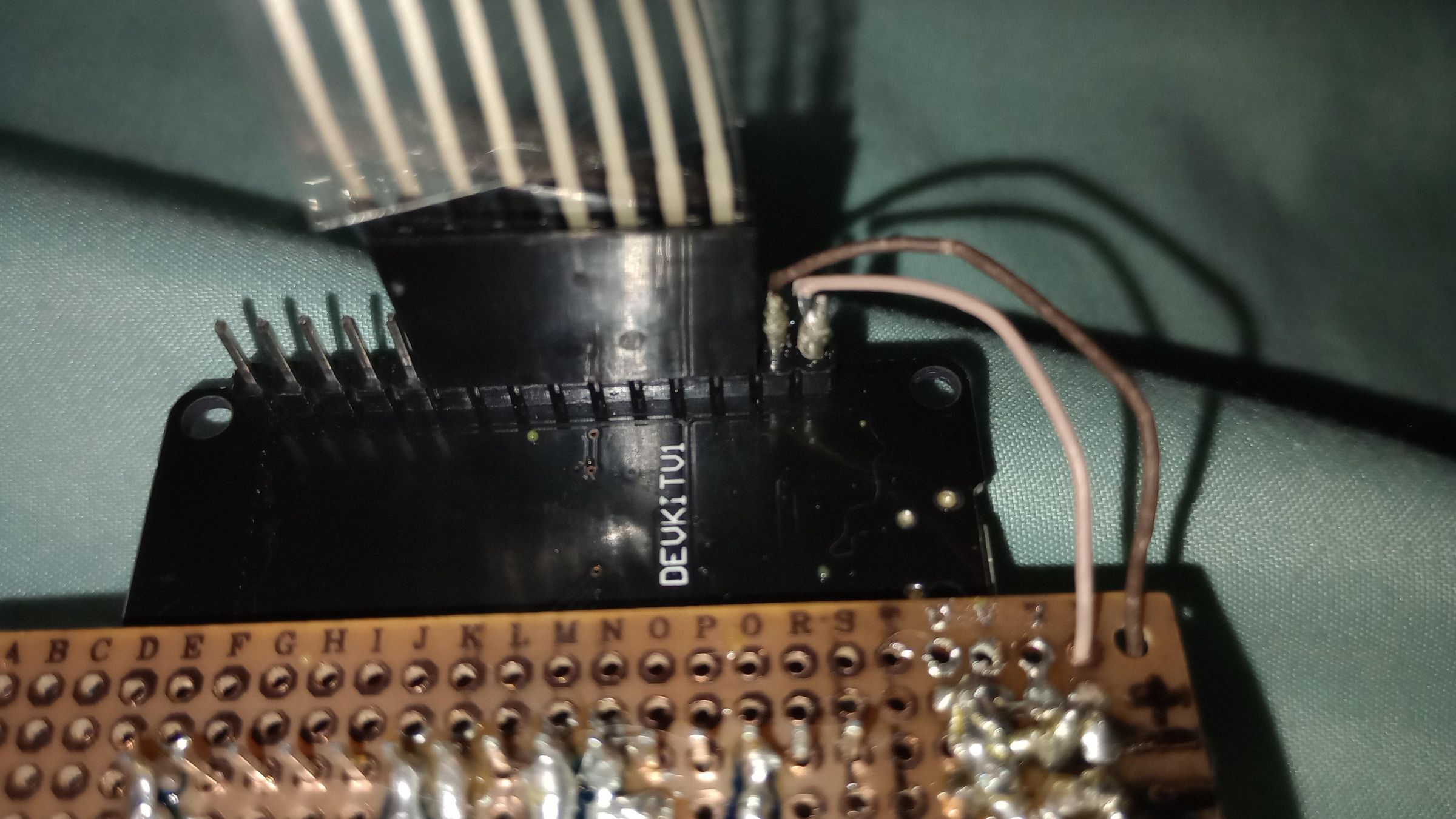

Step 1: Create the Circuit: LCD and ESP32
Pin Connections
LCD Data Pins:
Pin on LCD 16x2 => GPIO pin on esp32RW → GND
RS → 15
E → 16 (rx 2)
D4 → 17 (tx 2)
D5 → 18
D6 → 19
D7 → 23
Power and other:
A → 220Ω resistor → VIN
K → GND
VSS → GND
VDD → VIN
VO → Wiper → in1 → VIN
→ in2 → GND
(see image above)
Supplying power:
Connect 1 spare wire from the GND of the LCD to the GND of esp32
Connect the other spare wire from the VDD of the LCD to the VIN of the esp32 (make use of the 5 volts that the usb supplies)

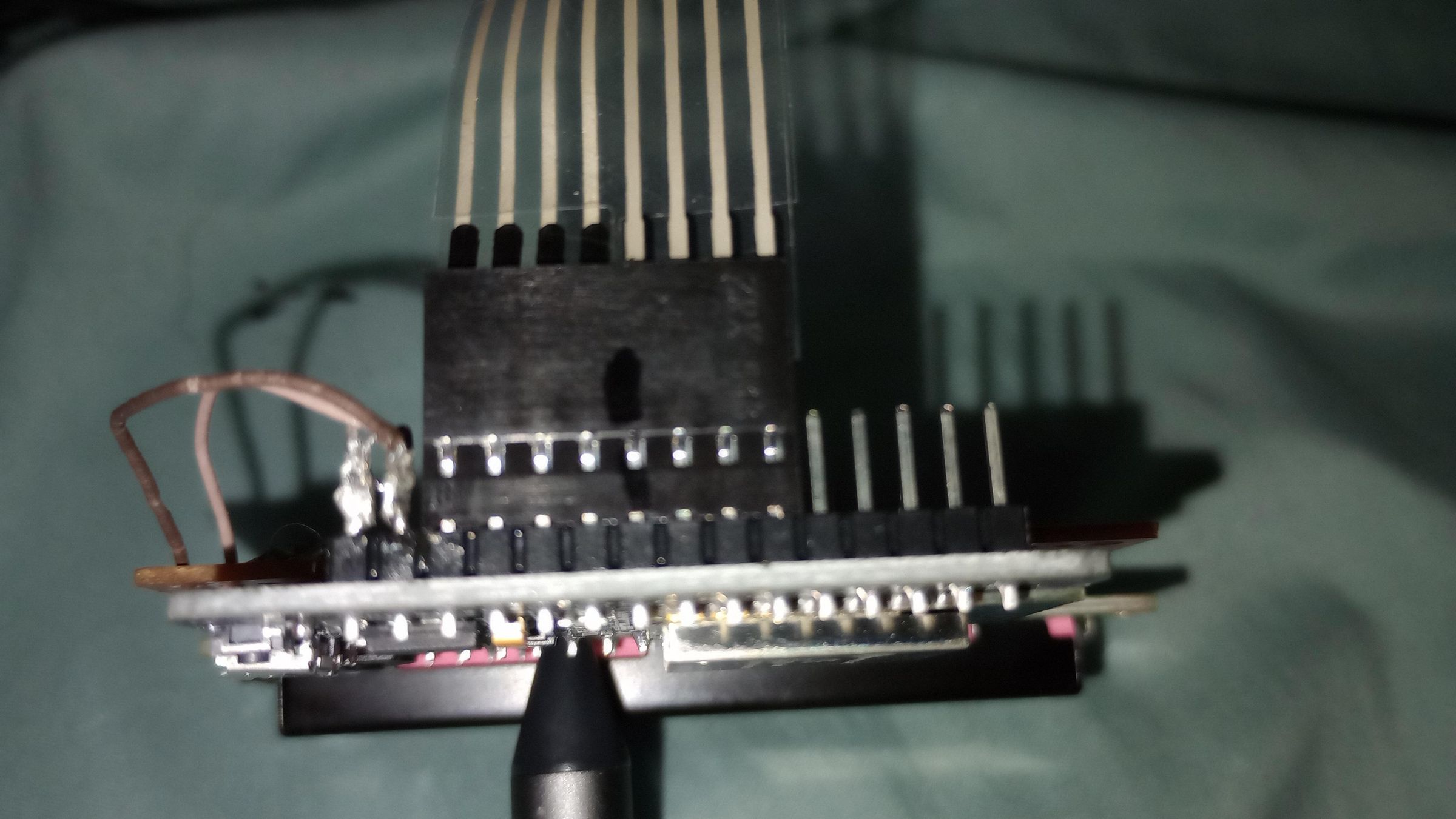

Step 2: Create the Circuit: Keypad Matrix and ESP32
Pins:
Keypad Data Pins:
Pin on Keypad Matrix → GPIO pin on esp32
Row 1 → 13
Row 2 → 12
Row 3 → 14
Row 4 → 27
Col 5 → 26
Col 6 → 25
Col 7 → 33
Col 8 → 32
(see image above)
With the order of the above pins, you are able to connect it directly like this:

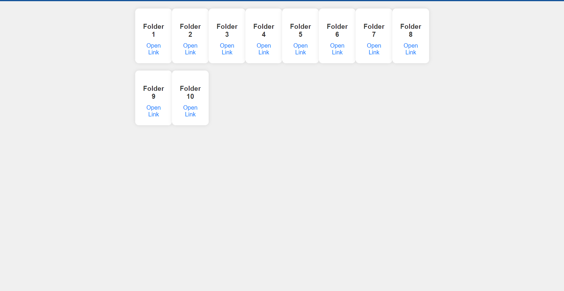

To access the home page, connect to the same Wi-Fi network as the ESP32 and got to the IP address of the ESP32. The LCD will show it for 3 seconds on connection, but if you can't remember, just hit the "A" key on the keypad matrix. The IP address may look something like this, "192.168.xx.xxx". The home page "/" will show something like this:
The home page:

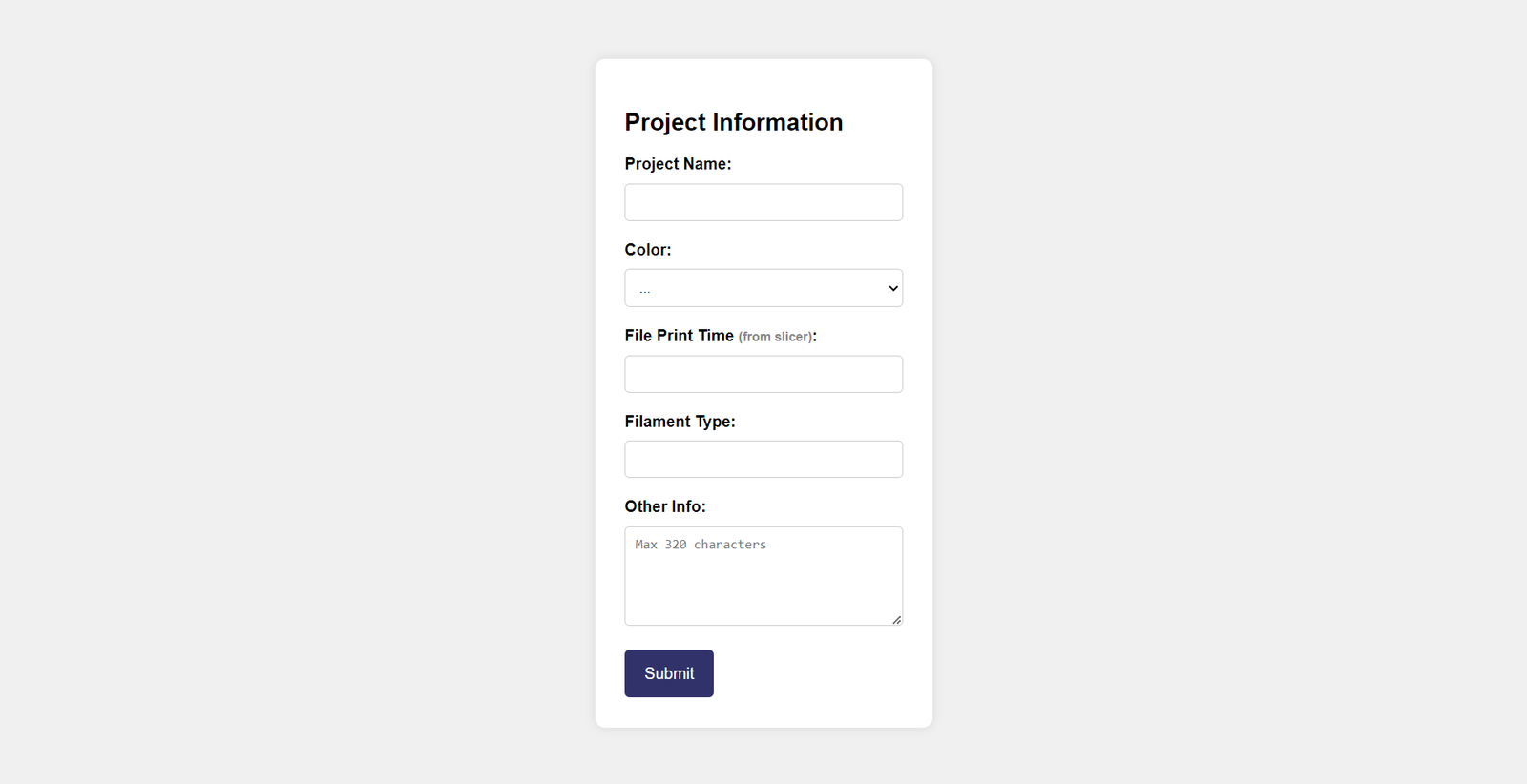

Just click on one of the project you would like to program in or replace, and it will take you to a screen like this:
Project Information:
Just fill in the project info and click submit. You will see a confirmation page if successful.
