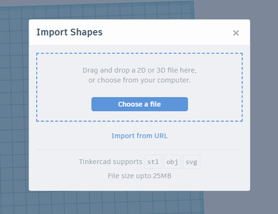

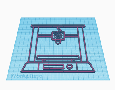

Now we have a corrected, flat Image that needs to be extended and converted to an STL to slice. So, in Tinkercad create a new design (big new design button on designs page) and import (the big import button on the top right of the page) the new svg file into Tinkercad. Here it will most likely be very big so resize the design to the size needed. Also, make the height to 0.2mm so it will only print one layer. Finally, export the design as an STL (the button next to import).
