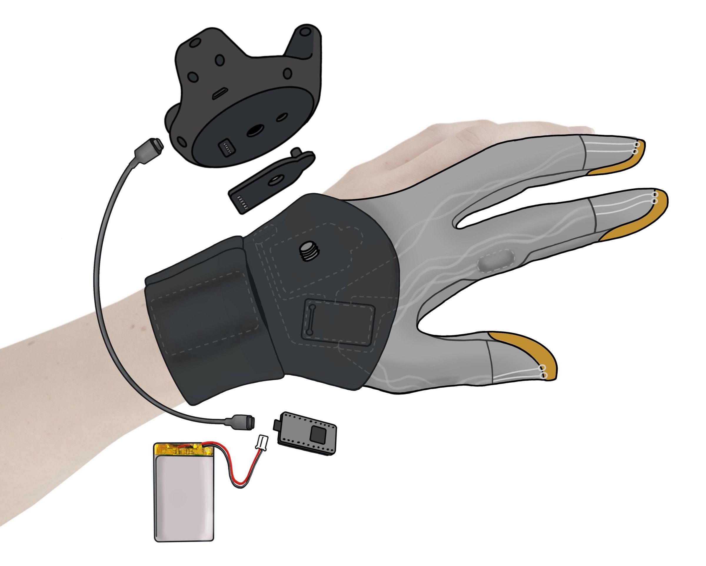

I want to use this snap idea in a glove design. I want to find a way to make detachable connectors for stretch sensors. The idea would be that this snap file can be integrated directly into a 3D printed sensor to connect it to a circuit.
