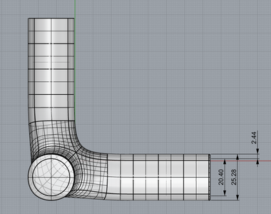

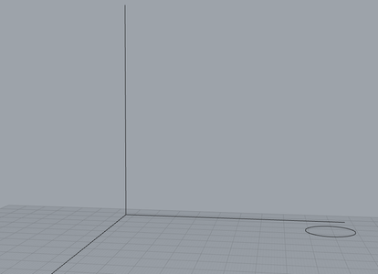

First, I use Rhino 7 to create the model. I make three lines, and then I use the multipipe tool in SubD to create the solid body. I found the problem that since SubD tends to keep everything smooth and curvy, the joint curves a little bit even though I have set the segment counts for each end into a comparatively high number. The solution is to make a solid joint first(not very accurate & could not attach to the wooden stick), and then cut off a perfect cylinder.
Things that worth mentioning is that the diameter of the cylinder is 20.4mm, 0.4mm longer than the diameter of the wooden stick that we are going to plug in. Indeed the thichness of the joint should be between 2-3mm.
