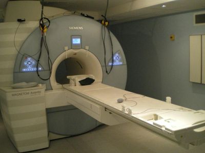

My housemate, Zarinah, who happens to be a neuroscientist, consulted me about how to make tools that no one would know the use of. My first thought was to hack together different things to create weird/random tools. Upon further investigation, it turned out she wanted two sets of MRI compatible tools (meaning they could not have any metal in them). The first set were replicas of existing, everyday tools that most people use. The second set were replicas of existing tools that were unfamiliar to most people. So my dream of hacking wild and crazy tools was broken.
So why do we need MRI compatible tools? There is a disability called apraxia in which people cannot execute motor skills . Their brains cannot communicate with their limbs. Apraxia is often caused by stroke but it can also be genetically passed down. These patients know what the tools are and how they are used, and can describe how to use them, but when they are handed the tool, they end up using it incorrectly. For example when handed a toothbrush, they brush their hair, or when handed a hammer, they put it in their mouth.
I suggested to her that we 3D print the tools. This would be perfect because it is possible to create exact replicas of things and 3D print them, and since they are plastic they are completely MRI compatible.

Step 3: MRI Studies!
Now that all the tools are printed, Zarinah will be testing non-apraxia people to see how their brains work when they are using tools. If non-apraxia effected parts of their brain are being using during tool use, those parts of the brain could be stimulated and possibly help apraxia patients relearn how to use tools.
