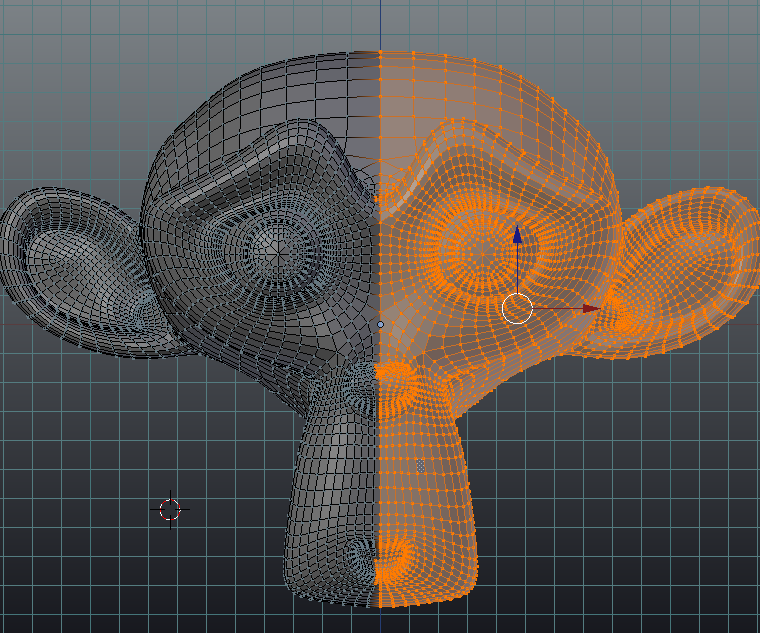

Next we will use Blender to make this model 3D Printable. First we need to convert the model to an stl format. We can do this by importing our model from Sculptris into Autodesk Mesmixer. Then export the model out of Meshmixer and import it into Blender. Once imported in Blender:
- Go into Edit Mode [tab] (convert triangles-->squares with alt+j)
- Select the Edge Loop [alt + right click]
- Extrude [E]
- Flatten out the vertices [S+(X,Y,orZ)+0]
- Fill in the hole [F]
- Export your model that you can now print!
Hint: You may want to add a smooth modifier if your model has a lot of noise.
