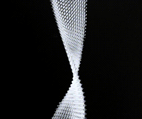

The idea of compacting 3D prints to fit inside smaller print volumes isn't uncommon in the SLS (selective laser sintering) print process. A great example is Nervous System's Kinematic Dress, pictured above. It consists of a series of moving triangulated joints that can be printed in a connected and folded configuration.

Although it is possible to print a thin sheet without any surface undulations, it is usually better to tile the surface with thicker regions so that it behaves more like a triangulated tessellation (think scored origami tessellations).
These thicker triangulated regions are easier to print and reduce the amount of extra-thin print layers, increasing the potential success rate of the print. Above are some tiling options and tests.
