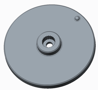

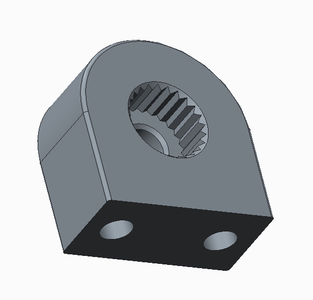

Here's an example part incorporating the spline geometry.
I've also included the solid part files to work with.
