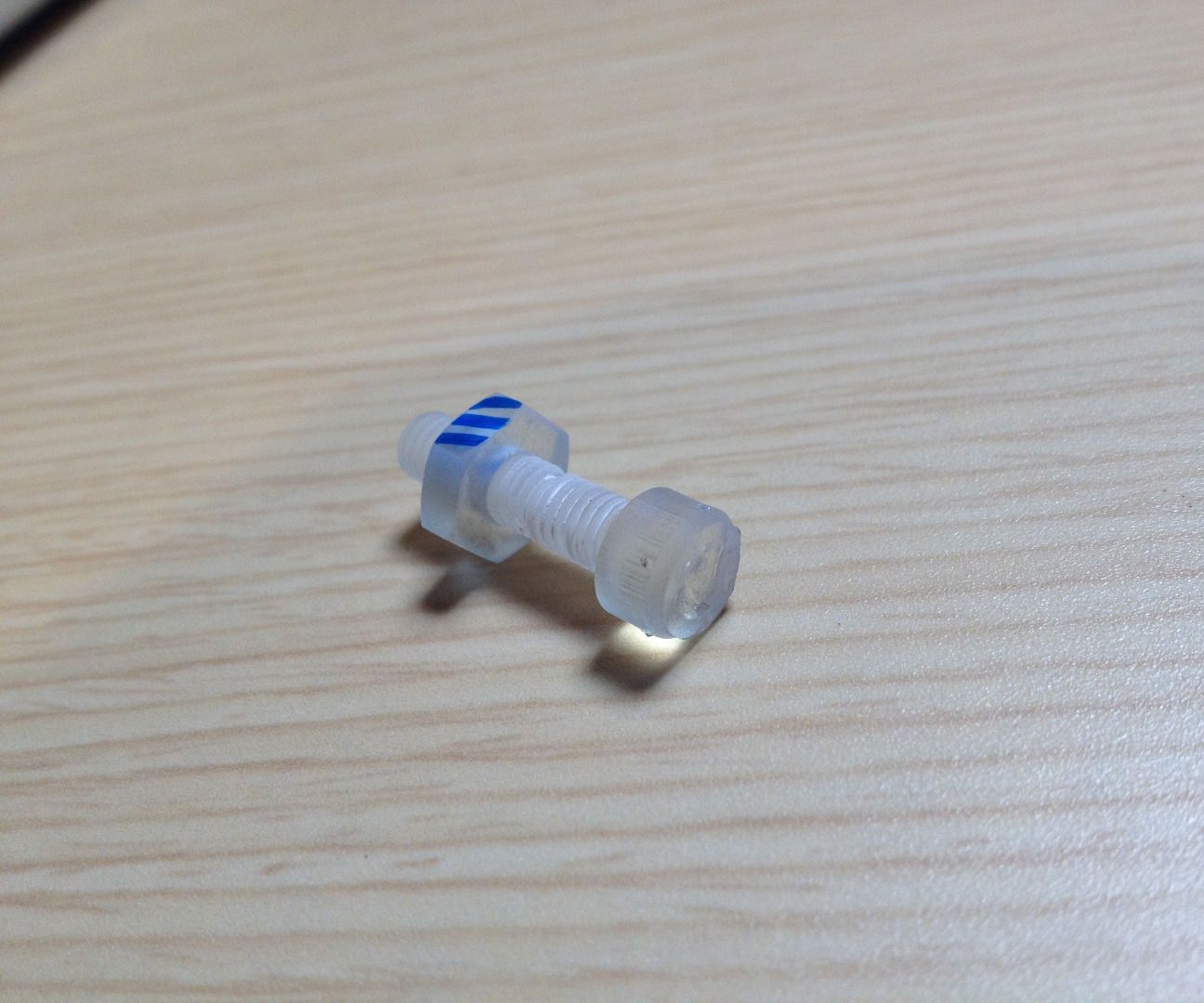

Upon initial inspection, the parts appear to have excellent feature resolution. However the thread dimensions do not seem to fall within the acceptable tolerance range. The nuts appeared to be “too small” when I attempted to thread the printed parts together. I tried threading an off the shelf ¼-20 bolt into the appropriate 3D printed nut and was also unable to successfully mate the parts. I ran a tap through some of the fasteners with thread sizes 4-40 and larger and was able to then thread the 3D printed nuts and bolts together with varying degrees of success. The bolts did not require any post-processing of their threads however the fit was somewhat tight when first assembled. The 4-40 3D printed nut and screw seized together eventually, perhaps due to cross-threading. The fasteners smaller than #4 were too delicate to attempt assembly. As expected, the material strength limits the feasibility of creating mechanical features below a certain size. I was also not able to assemble the pipe fittings.

It is also obvious that the material used does not wear very well. As the parts are threaded together, the assembly continues to produce “dust” as the contact surfaces wear away on each other
In conclusion, threaded features printed with Ember look quite impressive but are limited in functionality. Normally a lathe or other tooling is required to produce these sort of features. It is pretty cool that Ember can get as close as it does. As 3D printing advances I look forward to seeing more technology and results that fulfill real, functional need.
