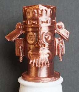

Step 3: Tláloc, God of Rain
This terracotta is either a brasero or an incense burner representing Tláloc, the god of the rain. Tlaloc is one of the oldest gods in Mesoamerica with representations dating back from the 1st century BC and was celebrated among the culture of Teotihuacan, the Aztecs and the Maya. This specific artifact belongs to the Aztec and is exposed in the National Museum of Anthropology of Mexico. The 3D reconstitution is available here.

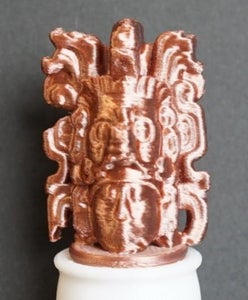

Step 4: A Priest Head in Copan's Temple
This head is an architectural feature of a maya temple on the archeological site of Copan in modern day Honduras. It may represent the bust of a priest of Chaac, the Mayan god of rain.
Settled as early as 1200 BC, the site of Copan developed gradually until is was refunded in 426 AD by the maya leader Yax Kuk Mo coming from the area of Tikal. Under his dynasty, the city of Copan prospered until the 8th century AD with a total population peaking at around 20 000 persons. The site was then gradually abandoned in the 10th century AD and "rediscovered" in 1570 by Diego García de Palacio during the Spanish conquest of the area.
The head is currently exposed in the Copan sculpture museum and the 3D reconstitution is available here.

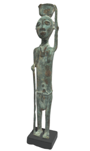

Step 5: Lobi Ancestral Figure
This statue is a bronze representation of an ancestral figure of the Lobi people. As Lobi are well known for their wood carving skills, their statues often present a very slender profile compatible with the shape of a tree trunk. Originated from modern Ghana, the Lobi people started to migrate westward in 1770 and is currently present in Burkina Faso and Ivory Coast. Animists and "acephalous" (organized without political central authority), this population is also renown for their practice of making marriage poles.
This statue belongs to the Arthur B. Steinman Collection, a 3D scan is available here.

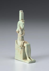

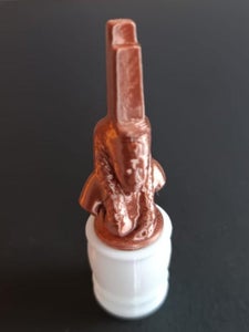

Step 6: Amulet of Isis
This amulet from Egypt represent Isis, goddess of maternity and magic, nursing her son the falcon headed god of the sky Horus. Made of faience, it is dated to the Ptolemaic era (305 to 30 BC). Central to the Egyptian pantheon, the cult of Isis later extended to the Greco-Roman world and was practiced well into the imperial Rome.
This amulet is part of the North Carolina Museum of Art collection and the 3D scan is available here.

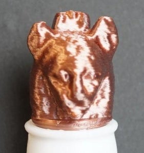

Step 7: Bastet
This second faience amulet from Egypt's Ptolemaic era (305 to 30 BC) represents the goddess Bastet. Initially represented as a ferocious lioness, Bastet evolved, merged with the goddes Sekhmet and became worshipped as a cat headed goddess by 1000 BC. Associated to fertility, possibly because of the strong reproduction abilities of domestic cats, Bastet amulets were also associated to the protection against illnesses and evil spirits.
This amulet is part of the Havard museum of the Ancient Near East collection and the 3D scan is available here.

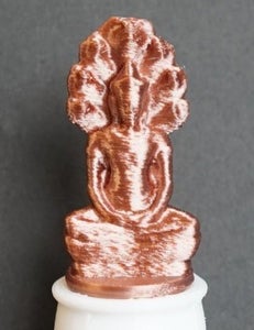

Step 9: Buddha Meditating Under a Naga
Originating from the historic Wat Na Phra Meru temple in Ayutthaya, Thailand, this 12th-century sandstone statue—carved in the Khmer style—depicts the Buddha meditating under the protective canopy of a seven-headed Nāga. In several South and Southeast Asian traditions, Nāgas are semi-divine beings, often depicted as half-human, half-serpent, inhabiting the netherworld (Pātāla).
In Buddhist iconography, the image of the Nāga Buddha symbolizes enlightenment, spiritual protection, and the harmony between humanity and nature.
From between the 7th-13th century CE, most of the Nāga-enthroned Buddhas found in Thailand were in the northeastern part of the country, where the Khmers had an increasing presence.
This sculpture is exposed at the Chao Sam Phraya National Museum in Ayutthaya. The 3D reconstitution of this statue is available here.

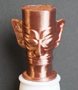

Step 10: Sanxingdui Head
This is a representative example of a Sanxingdui head. Sanxingdui refers to a major Bronze Age culture located in present-day Guanghan, Sichuan, China. Archaeological excavations at the site have uncovered artifacts dated by radiocarbon between the 12TH-11th centuries BCE. These findings point to the existence of a distinct and advanced civilization in this region, long before it was annexed by the state of Qin in 316 BC.
While Sanxingdui heads share a common overall appearance, they vary in details such as hairstyle and head shape. The hair of this head is tied back, adorned with an accessory. Some scholars have speculated that these differences may indicate variations in race or identity. The heads are hollow inside, suggesting they may have once been attached to bodies made from perishable materials like mud or wood.
Most of Sanxingdui artifacts are now displayed in the Sanxingdui Museum located near the city of Guanghan. The 3D reconstitution of this statue is available here.

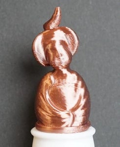

Step 11: Tang Dynasty Female Tomb Figurine
The Tang Dynasty is often seen as a golden age for women, reflected in its remarkable female tomb figurines—key examples of Tang sculpture. Rooted in the belief in an afterlife, these earthenware figures were buried alongside the dead, accompanied by animals, tools, and other symbolic items for use in the next world.
The style of these figurines evolved over time: early versions featured slender bodies and delicate faces; during the dynasty’s peak, fuller, more voluptuous forms reflected ideals of beauty; later figures appeared slightly bloated. Their varied hairstyles, elegant garments—often with exposed necklines and arms—and rich colors vividly capture Tang society, offering valuable insight into its culture, fashion, and ideals.
The 3D scan of this figurine is available here.

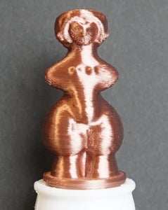

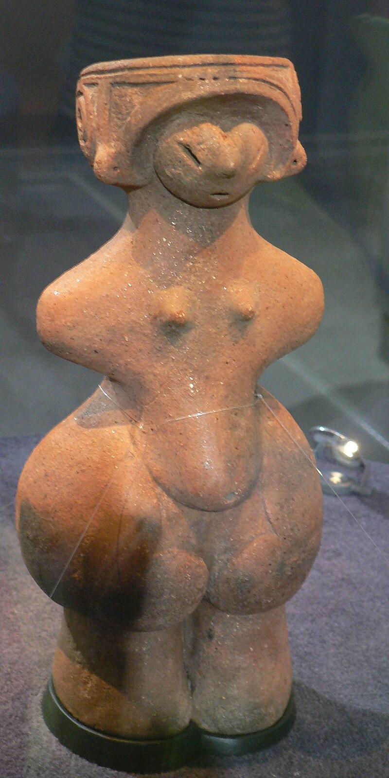

Step 12: The Jomon Venus
Discovered in the town of Chino in Japan, the Jōmon Venus is atributed to the Jōmon culture during its middle period (3,520–2,470BC). This small statue representing a pregnant woman is characterized as a dogū, a type of small humanoid or animal figurine possibly used as votive offering in rituals.
The Jōmon population, predominantly sedentary hunter gatherers, where later replaced by Yayoi people (around 500 to 300 BC) immigrating from the continent and bringing an agricultural lifestyle together with the precursor of modern Japanese language.
The head is currently exposed in the Chino Museum and the 3D reconstitution is available here. For printable files refer to the end of this instructable.

If one or more of those art-pieces catch your eyes, you may want to print it. All the files can be found here and here. I have designed those corks to be printed as two separate components and screwed together.
The first part, to be printed in PLA or any rigid plastic of your choice serves as a "handle" with the art-piece shape. It should be printed with the highest possible resolution (ideally 0.06mm layer high with 0.2mm nozzles) and most parts requires tree supports. You may also want to use "fancy" filaments for their esthetic effects. The examples I showed throughout this instructible are printed in copper colored PLA silk.
The second part is the cork proper. It should be printed in TPU and I've done all my tests with 95A TPU (if you are not familiar this number indicates the rigidity). The cork prints best with 0.4 line with and 0.2 layer height. No supports are required. The cork exists in 3 versions: S, M and L. M size is optimized for standard (at least standard in France) 18.5mm bottle. The cork geometry contains an internal air pocket that ensures a good contact with the bottle sides even if the diameter is a bit off. However bottle diameters tend to vary quite a lot depending on where in the world they are produced so the L size is for bottles wider than 19mm and S size is for diameters lower than 17.5mm. If you buy bottles from around the world, i would recommend to have one of each and just check which one fits best...
Once you have both parts printed, just screw them together and its ready.
