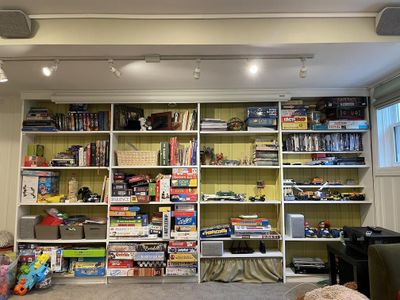

Kids playroom by day, home theater by night.
We love to watch movies in the kids playroom at night on a projector with a pull-down screen. We recently decided to add surround sound to make it even more awesome. Our goal was to create the best, most immersive movie experience possible without putting ugly speakers everywhere.
In the end we were able to 3D print our way to a 5.1.2 Dolby Atmos home theater. All of the speakers are finished with gray fabric that blends with the white walls. The speakers were designed in Tinkercad. SpeakerSim, WinISD, and Xsim were used for the electrical and acoustic design. In-room testing was conducted using Room EQ Wizard (REW). All software used in the creation of the speakers is available for free.

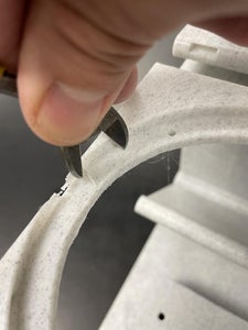

When you pull the 3D printed speaker base off of the printer you will first need to remove the supports for the speaker driver hole. Scrape away excess material and make the hole round enough to fit the CX120-8 driver in the slot. I used a pair of side cut pliers to scrape and a junky old soldering iron to melt any flaws away.
Try inserting the driver in the hole. It probably won't fit initially, so be patient and remove material slowly until it fits. Once you have verified that the driver will fit, remove the driver and perform the next step.
NOTE - Fluctuating temperatures and high humidity over the 73 hour print time caused my final enclosure to warp and string while printing. The print didn't fail, but it turned a perfect circle into an oval. I used a Dremel to trim away more than 2 mm of material from the bottom to fit the driver.

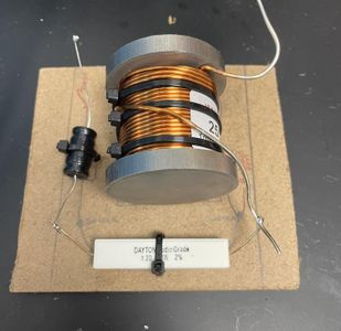

Step 7: Assemble the Crossover
For this step you will need:
- 110 mm x 90 mm x 3 mm (1/8") thick piece of hardboard
- pencil or pen
- drill with 1/8" drill bit
- needlenose pliers
- side cutters
- (8) 4" zip ties
- 1.0 mH inductor
- 4.0 microfarad capacitor
- 1.2 Ohm resistor
To mount the crossover you can use any material you like, just as long as it is 1/8" thick and a 90 mm x 110 mm rectangle. The exact dimensions aren't critical, just as long as you are within a few millimeters either way. I had a large sheet of hardboard that I cut down with a jigsaw to make boards for all three speakers.
- Mark an 80 mm wide section in the middle of the board in pencil (see photo). This is where the electronic components will go.
- Layout out the capacitor, inductor, and resistor as shown in the photos.
- Mark and drill mounting holes for the zip ties.
- Attach zip ties, inserting components into zip tie loops. Pull the zip ties tight with pliers, then trim the extra zip tie material with side cutters.
- Solder the one resistor lead to one capacitor lead.
- Solder the other resistor lead to one inductor lead.
The crossover board is complete and ready to install!

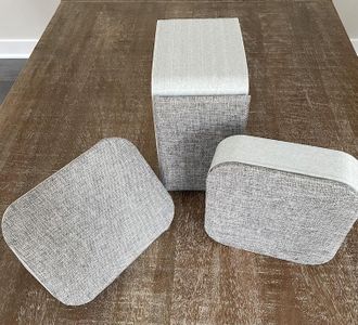

Step 13: Surround Speaker Design
The four surround speakers use the same wide-dispersion BMR driver to provide uniform sound even when you are sitting way off axis. This is critical for our space because we need speakers that can be mounted flush to the wall almost directly above the couch.
I used Tinkercad to create two physical designs using the same Tectonics TEBM46 BMR speaker driver. The two designs are very similar acoustically. They have the same internal volume of 0.85 liters, with an 18 cm long port with a cross section of 8 cm^2.
The "On Wall" TEBM46 is a 7.5 inch x 7.5 inch x 2 inch deep rounded square. The corner-mount TEBM46 is designed to fit between a soffit and a wall and is used as an overhead speaker in our room. It is 9 inches long and will take up about 5 inches of linear distance on the wall and ceiling. Both designs have integral keyhole mounts for #6 wood or drywall screws. There is zero gap between the speakers and the wall when mounted.
According to WinISD models both designs should have a frequency response of 110 Hz - 20,000 Hz. They are larger than many "home theater in a box" surround speakers, but they can play lower and have a sound that belies the size of their tiny speaker driver. The TEBM46 driver has a very respectable efficiency of 88 dB / 1 Watt. This is a great match for the CX120 main speakers. The TEBM46 is only 4 ohms, so it will play louder at a given setting on the volume knob, so it will be necessary to run the AV receiver's automated speaker calibration to bring the surrounds down to the same volume as the main channels.
Because they use a single speaker driver with a flat frequency response they don't need a crossover or filter. This keeps the costs way down. A single TEBM46 speaker can be made for about $50.

Step 20: TEBM46 Speaker Complete!
Congratulations!
These speakers are very versatile. If you are like me you built 2 of the On Wall version for side surround duty on the rear wall, and 2 of the Corner Mount version as overhead speakers.
Since both designs are similar acoustically feel free to print what you need and place them where they make sense in your room. Heck, if you really need on wall speakers you could even use these on the front wall as your main channels. Just be sure to set your crossover to at least 110 Hz!
