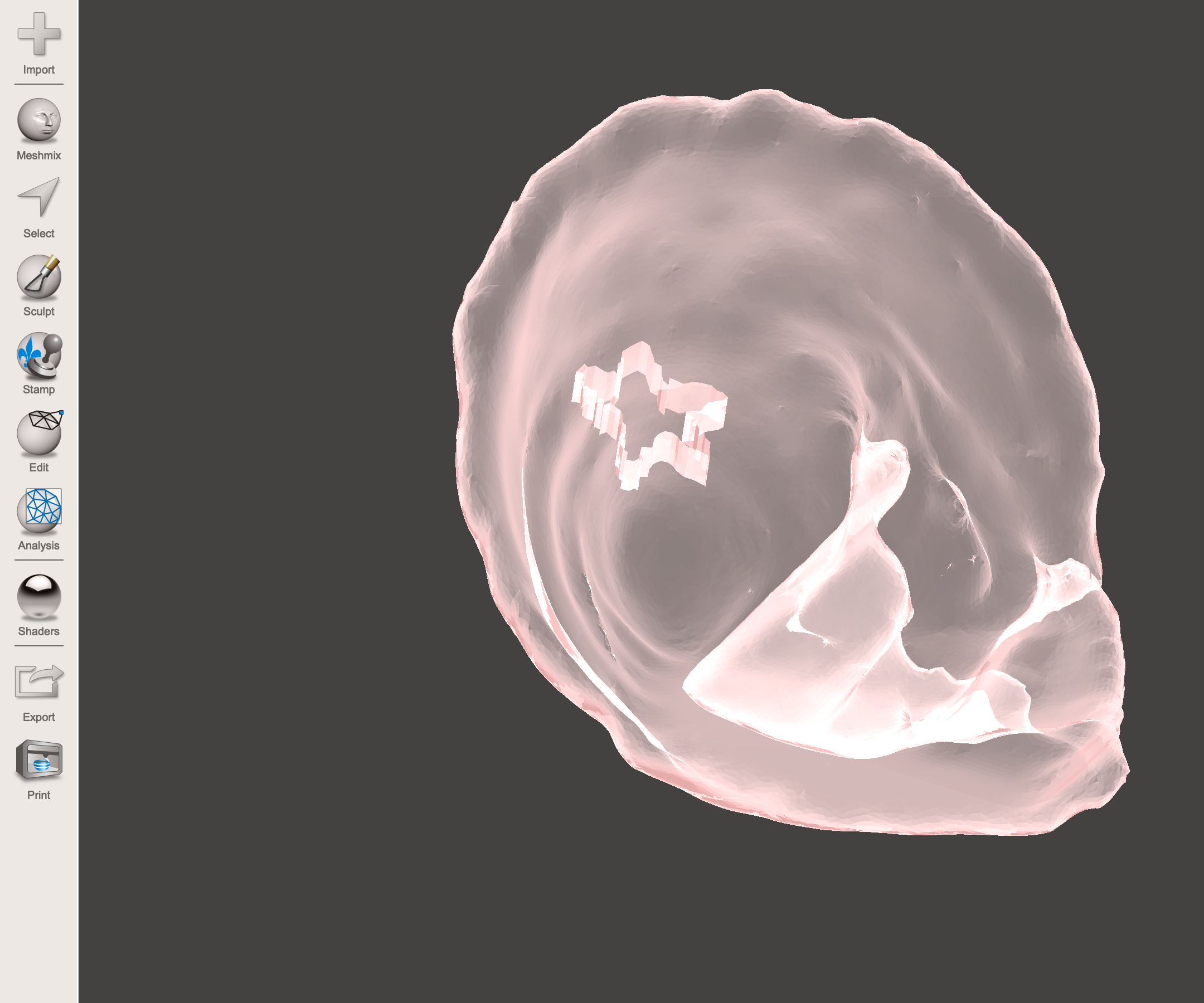

I started with a 3D pumpkin model downloaded from the internet made by papaisur. Meshing editing is conducted in Meshmixer. After cutting off the top section, I tried to make a container using the pumpkin shape.
The first way I explored is selecting and extruding some mesh on the top. It worked fine but you can imagine that a lot of materials are wasted inside the wall. What I really need is just an outer shell with a preserved shape of the object. So the second way I explored is selecting the outside surface of the object and creating an offset to generate a shell-like structure.
