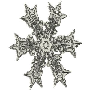

Step 1: Choose Your Reference Images
The first step to obtain a model like mine, is to find the right source images to use.
I went through the wide collection of snow flake microscope pictures that professor Libbrecht shared with me, and I choosed 3 of them. Doing so, I took into consideration, beside the aesthetics, the solidity of the resulting printed object (SLS technology requires a minimum wall thickness of 1 mm).
These pictures show real snow crystals and they were captured by Kenneth G. Libbrecht using a specially designed snowflake photomicroscope.

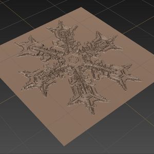

Step 3: Displacement Mapping
The technique that I've used to transform the pictures of real snow flakes into digital 3D models is called "Displacement Mapping", and can be performed by several 3D modeling softwares, like Mudbox, Zbrush, Maya, 3DS Max and more.
The greyscale images previously created are applied to a 3D shape (In my a case, a plane): the sofware will bump up the white areas of the images, creating a 3D relief.
The range between the highest and lowest point of the bump, can normally be specified by the user;
I kept it around 1 mm in order to make the details well visible on the 3D print.
