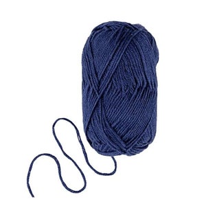

  7. Colored Yarn

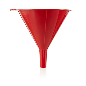

  15. Funnel

B. Eyes (White + Dark Blue Yarn)
  1. Use 16 nails in an oval to form the outer white part of each eye.
  2. Wrap white yarn back and forth between the nails to form the eye shape.
  3. Now, use 8 nails in a smaller oval at the center to form the dark eye center. Use dark blue yarn to fill in the pupil.
C. Smile and Eyebrows (Dark Blue Yarn)
  1. Use 14 nails in a curved line to form the mouth.
  2. Wrap the dark blue yarn in a smiling arc between these nails.
  3. Use 4 nails per eyebrow, placed slightly above each eye. Loop dark blue yarn across them to form the eyebrows.
