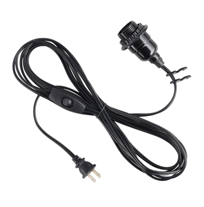

  6. Plug In Pendant Light Cord

My inspiration stemmed from a similar design I wanted to recreate and put my own twist on. I knew I wanted to recreate the sun rays to resemble those in my previous designs. I believed it truly differentiated it from the inspiration. Coming up with the separate components was definitely the most challenging part, as it revolved around the Plug-In Pendant Light Cord. I definitely knew I needed a support backing with a hole to hang from and an indent for the light cord so it could lie flat against the wall when hung. An important detail was to ensure the light would shine through, making the base of the dome with an opening very important. Thankfully, I had the retaining ring for the lightbulb socket to secure the components in place, but I also had to make sure the dimensions of the pieces fit it.

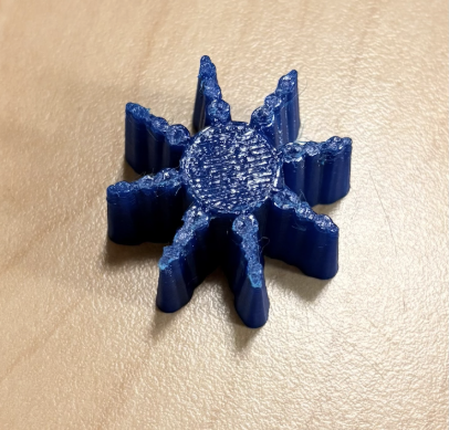

After printing, I did have to glue the sun rays components together as I had to cut it into quarters to accommodate the 3D printer's max dimensions. After, I decided to spray paint the components a gold metallic color and use spray paint gloss to ensure durability.
