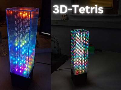

Introduction: 3D Tetris on a 3x3x12 LED Matrix
About: I'm designing some small projects in my free time or at my work in a MakerSpace. Also, I upload some of my school projects. I'm always working on three projects at the same time, so the upload is a little fuck…
Welcome to the 3D Tetris project! This Instructable documents the creation of a 3x3x12 LED matrix that enables users to play a fully functional 3D Tetris game. The project leverages an ESP32-based development board (ESPduino) with integrated web server functionality for remote control. You can also find the project on GitHub.

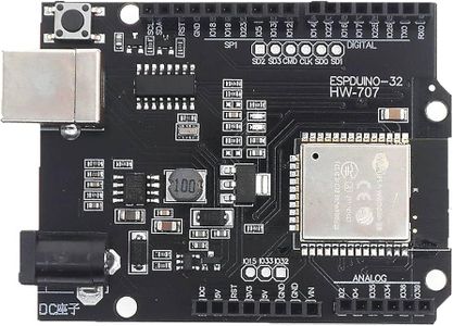

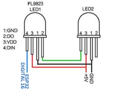

1. Connecting the ESPduino
  1. Solder the Digital Pin 16 of the ESPduino to the data input of the LED matrix.
  2. Connect the 5V and GND lines from the matrix to the ESPduino.

  1. Begin by soldering the power connections:
  2. Pin 2 (5V) of each LED should connect to a common power bus.
  3. Pin 3 (GND) connects to a ground bus.
  4. Use welding rods cut to size for the power and ground rails.
  5. Straighten the rods using a drill and vice to ensure clean alignment.
  6. Be sure the rods are straight, or your matrix will end up with a bend in it, like you can see in the picture.
4. Connecting Signal Lines
  1. Solder the DIN (digital input) of each LED to the DOUT (digital output) of the previous LED in the chain.
  2. Follow the predefined order to ensure signal continuity.
  3. Test connections after completing each layer to catch errors early.

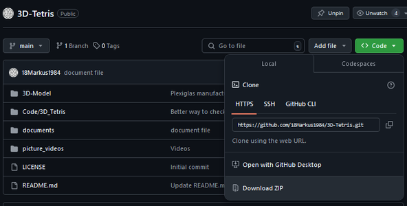

Step 5: Installation
Software
  1. Arduino IDE: Download and install the Arduino IDE.
  2. ESP32 Board Manager: Add the ESP32 board manager by following this guide.
  3. Libraries: Install the following libraries:
  4. Via Arduino IDE Library Manager:
  5. FastLED
  6. WiFi
  7. Preferences
  8. ESPForm Library:
  9. Download the library from the ESPForm GitHub repository.
  10. Extract the downloaded ZIP file.
  11. Copy the extracted folder into the libraries directory of your Arduino IDE sketchbook folder.
Upload
  1. Clone/Download the Repository
  2. Open a terminal and run the following command to clone the repository:
git clone https://github.com/18Markus1984/3D-Tetris.git
  1. If you don't know how to us the command window, you can also manually go to the GitHub repository and download the complete project as a zip-File.
  2. Open the Project in Arduino IDE
  3. Navigate to the cloned folder and open the .ino file in the Arduino IDE.
  4. Configure the ESP32 Board
  5. Go to Tools > Board and select ESP32 Dev Module.
  6. Enable PSRAM under Tools > PSRAM.
  7. Upload the Sketch
  8. Ensure the correct COM port is selected under Tools > Port.
  9. Click the Upload button to flash the code onto the ESPduino.

  1. A fully functional 3D Tetris game displayed on a custom 3x3x12 LED matrix.
  2. An intuitive and user-friendly web-based control interface.
  3. A modular and scalable design, paving the way for future enhancements such as battery power and improved structural stability.
