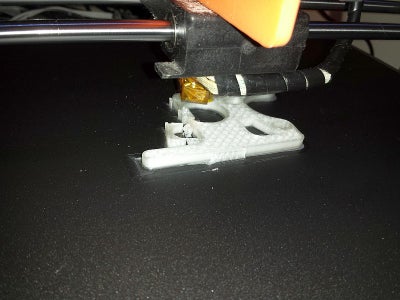

Installed on my print bed is this 30x30cm sheet now:
The difference to normal ways of printing comes visible when you see how well the plastic sticks on the sheet and how well defined the lines are.
As I have no heated bed for my old printer I will try to print ABS directly onto the cold sheet:
And a bit further into the print still no peeling off or any of the usual problems.
Printed with a 4mm brim around the object.
Bit tricky to work with one hand so forgive the bad video, but here you can see the removal of the part:
It really is not easy with one hand, but after some tapping on the outside of the part it breaks off the brim.
I had troubles holding the platform and the cam, so I cheated a bit with a plastic scraper.

If you use a brush right after the print surface is back to good after drying.
This way it is possible to print PLA without warping and without a brim - something that comes handy for certain parts.
ABS did cost me some nerves and near breakdowns.
Small parts were no problem with ABS juice, even if applied on top of the sugar coating.
The bigger the part and the more solid the first layers, the more I experienced the usual warping off the build plate.
Against common "rules" I decided to now go the other with the first layer: print it thin instead of extra thick!
So instead of going to 0.2mm or more I started the first layer with just 0.1mm.
The speed was reduced as well and the line thickness increased to 120%.
This made the first layer stick fine but the second peeld off later in the print :(
A cold blonde gave me a brain storming experience and I played with the layer temps.
I already started at 250° for the first layer but went down to 235 right after.
The new settings started at 260°, 255° for the second and third layer and after that 245°.
Now all was sticking fine :)
Big parts require a brim of up to 30 lines wide but they print ok.
Oly problem I noticed is that after you got them off the plate they still warp a little bit.
