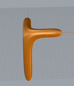

I chose to use SubD to make a more organic shape.
Here's the picture of the final product(not polished).

In order to connect three sticks together, I need to draw three lines along the x, y, and z axis using the polyline command.
And then moving on to the SubD tool: Multipipe. I selected all these lines to build the shape. Because the thickness of the joint is at least 2mm in order to support the weight of the wood, so I made the diameter 22mm.(The diameter of the wood stick is 20mm)
Step 2: Insert SubD Edgeloop
Next, I need to insert the edge loop, because each end of the branch is too round and thin.
So, I use the insert edge loop tool.
