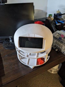

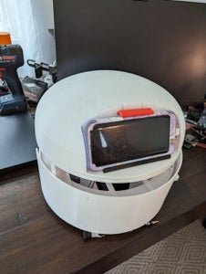

Introduction: 3D-printable Arduino Pet Robot
Snoopy was designed in Fusion 360 and printed using a Voron 2.4r2 350mm and a Prusa MK3S. It has an ESP32 micro-controller, Arduino firmware, two motors with a caster, a laser scanner sensor (and in a next revision a Raspberry Pi Pico with servos). It has an old smartphone or 7" tablet as display, microphone, audio and IMU.
Once finished, it will act as a pet - play ball, hide-and-seek, chase, demand its owners' attention and greet its owners happily at the door. Utilitary functions will include patrolling the house. Here is a preview of Snoopy playing ball in a simulation.
Snoopy runs on kaia.ai software platform developed at remake.ai.
