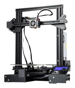

  • 3D-printer

Step 3: 3D-printing
3D-printing plays an very important part in producing the 3D-scanner, that's why I will go into further detail about the print settings, time, etc. The following parts need to be 3d-printed:
  • Body
  • layer height: 0.3mm
  • line count: 4
  • infill: 20%
  • bottom and top count: 4
  • Speed: 80mm/s
  • Support: everywhere
  • Support overhang angle: 30 degrees
  • print time: +/- 11 hours
  • Steppergear
  • line count: 4
  • infill: 20%
  • Speed: 50mm/s
  • print time: +/- 0.5 hours
  • Cover
  • line count: 4
  • infill: 20%
  • Speed: 50mm/s
  • print time: +/- 1 hours
  • Circle-gear
  • line count: 4
  • infill: 20%
  • Speed: 50mm/s
  • print time: +/- 4 hours
  • Phone-holder:
  • line count: 4
  • infill: 20%
  • Speed: 70mm/s
  • print time: +/- 1.5 hours

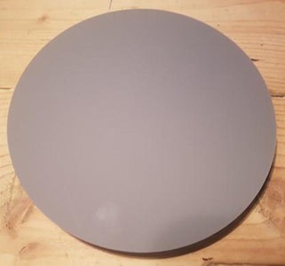

Step 4: Laser Cutting
I made the rotating disk of the 3D-scanner by laser cutting the STL file out of an 4mm thick acrylic plate. Laser cutting is the preferred way of manufacturing since when using laser cut colored acrylic it will reflect less light then a 3d-printed part which is beneficial because your phone will take better pictures which results in a better 3D-scan. However, this part could also be made with a 3D-printer, since it fits most 3D-printers with it's diameter of 150mm.
Use the manufacturers given values for speed and laser power when laser cutting the acrylic.

After all the components were installed, wired and the software had been uploaded onto the Arduino, I pressed the stepper gear onto the stepper shaft. I attached the big circle gear onto the disk with super glue, be cautious that you place the gear exactly right so the disk spins circular and not like an oval.
