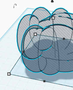

Step 2: Squeeze It
Non-uniform scale of .8 in y axis

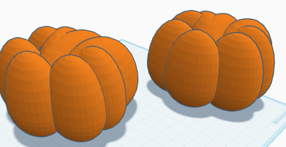

Step 3: Copy It
Make a copy of the ball and move it over
Step 4: Copy the Copies
Copy that pair and rotate the new pair 36 degrees
Step 5: Repeat!
Make 3 more pairs of copies and you'll have the body of the pumpkin

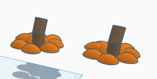

Step 8: Extend the Circle
Rotate the circle to be perpendicular to the path and create the stem by following the path with the circle

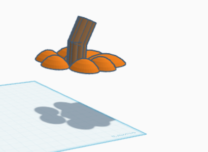

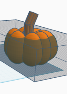

Step 9: Insert Stem
Move the stem into place on the body of the pumpkin. You will likely need to change the scale of it

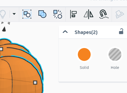

Step 10: Combine
Connect all of the shapes together

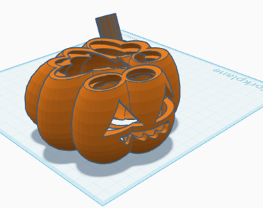

Step 11: Shell the Pumpkin
Hollow out the pumpkin with the shell tool
Step 12: Cut a Hole in the Bottom
Create a cylinder and subtract that from the main shape. You now have a hollow pumpkin with a space for a LED candle to be inserted.

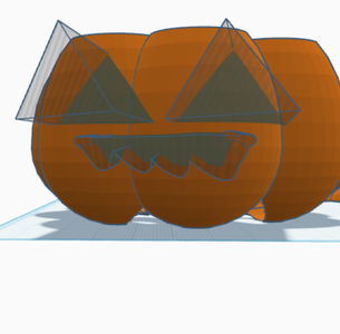

Step 13: Cut a Face
Make your own face for the jack o' lantern by subtracting different shapes. When you're happy with the results you can export an STL and print it!
