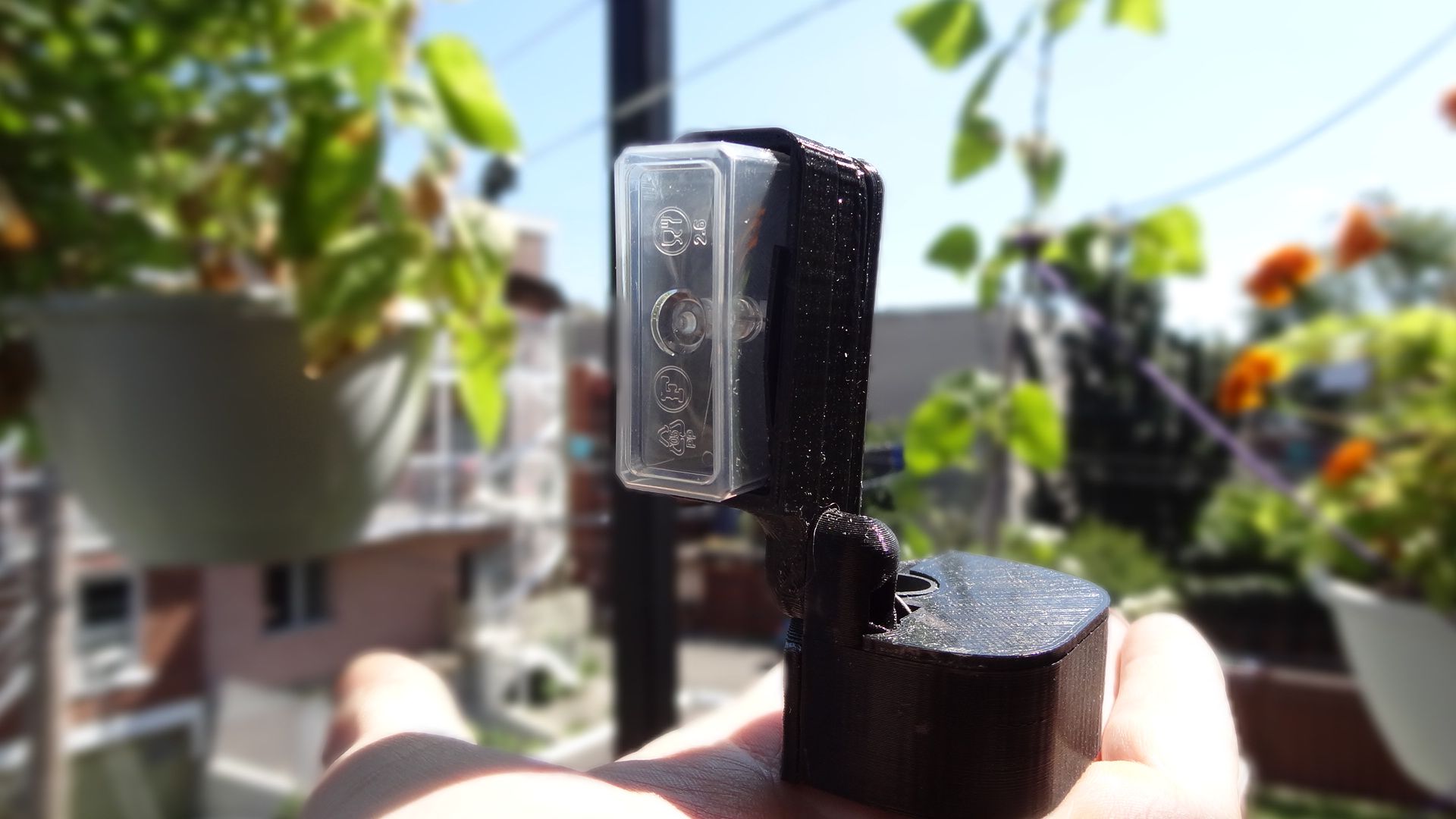

Step 4: Step 4 : Place the Generator
Take the microgenerator and place it as it's made for.
Normally you can only put it in one sense.

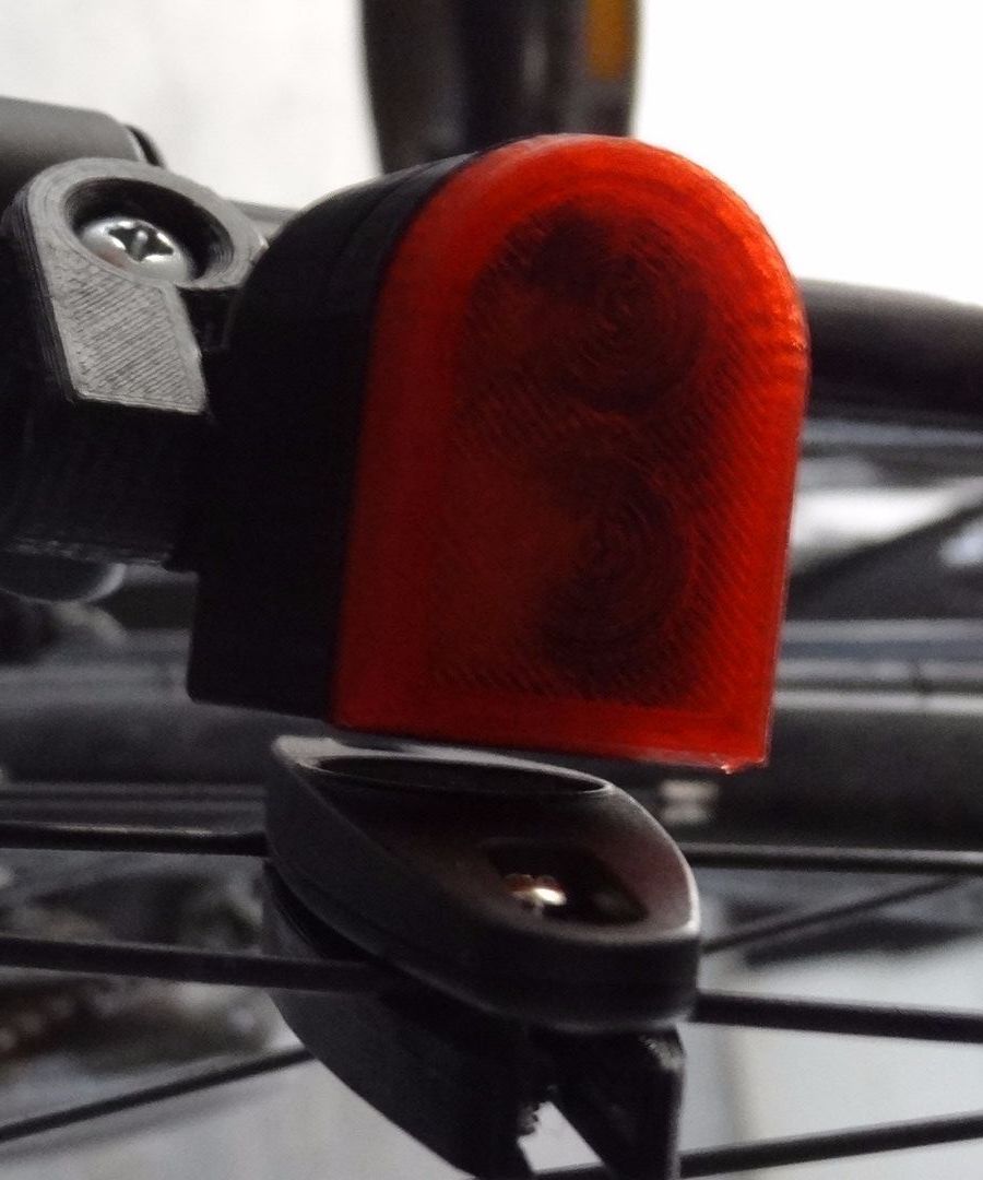

Step 6: Step 6 : Plug the Wires and Hide Them
So plug the connector to the hole drwan on the light box.
Then plug the LEDs before it's to late !
And hide the wires using th top designed for.
Then put the top on the general box as shown in the pictures.

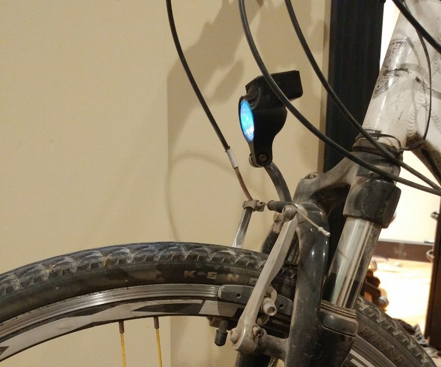

Step 9: Install on Your Bike
Screw the screw and adjust the magnet so it will passes just in front of the generator.
Step 10: Enjoy :)
