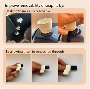

Also it might be worth taking into account how to remove the snap-fits again once they're in position. In many products snap-fits are used in assemblies that are almost impossible to remove once they are in position, this might be because the design itself hasn't accounted for removing the part, they are impossible to reach or because they are attached with 3+ snap-fits that need to bend backwards simultaneously.
In the figures are two methods we used to make the snap-fits more easily removable.
  • By not making them use 3+ snap-fits (general).
  • By making them easily reachable.
  • Or by allowing the part with snap-fits to be pushed through.

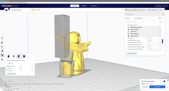

It is important to print your snap-fits with 100% infill, otherwise they will break. It is understandable that you wouldn't want to print your whole model with 100% infill. In that case you can use the support blocker tool in Cura. By applying the support blocker to your model, you are able to edit the print settings for small parts of your model.
If you want further detail on how to work with support blockers, you can watch this video. If you want to edit the shape of your support blocker you can download the Mesh Tools plugin to be able replace the support blocker cube with any .stl or .obj file.
Look at this forum post to find out how you can use this tool.
