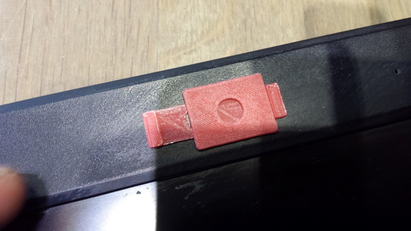

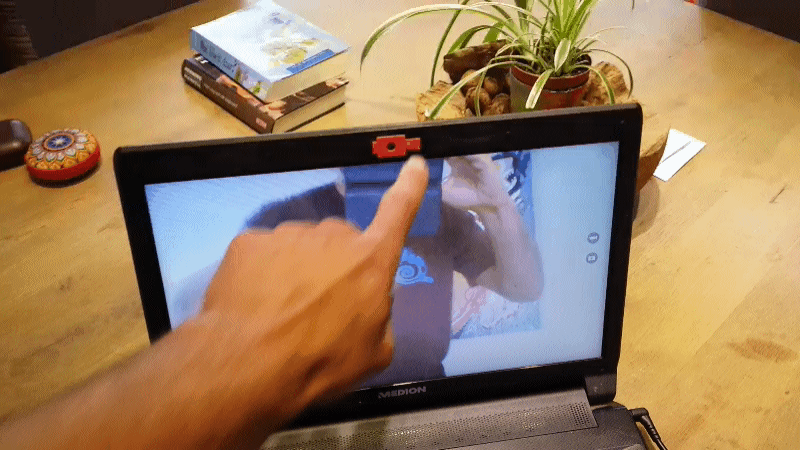

I see many laptops and notebooks from which the camera is covered with a post-it or a piece of tape. I found a few 3D printed clip on camera covers with Google but I wanted something more elegant. Even if you do not have a 3D printer it is extremely cheap to get one through a 3D printing service (I recommend 3Dhubs). The print only requires 6cm of (3mm) filament.
I made this camera slider as thin as possible (1.2mm) so you still can close your laptop. The camera hole size is 7mm diameter so (I think) it will fit most modern laptops.

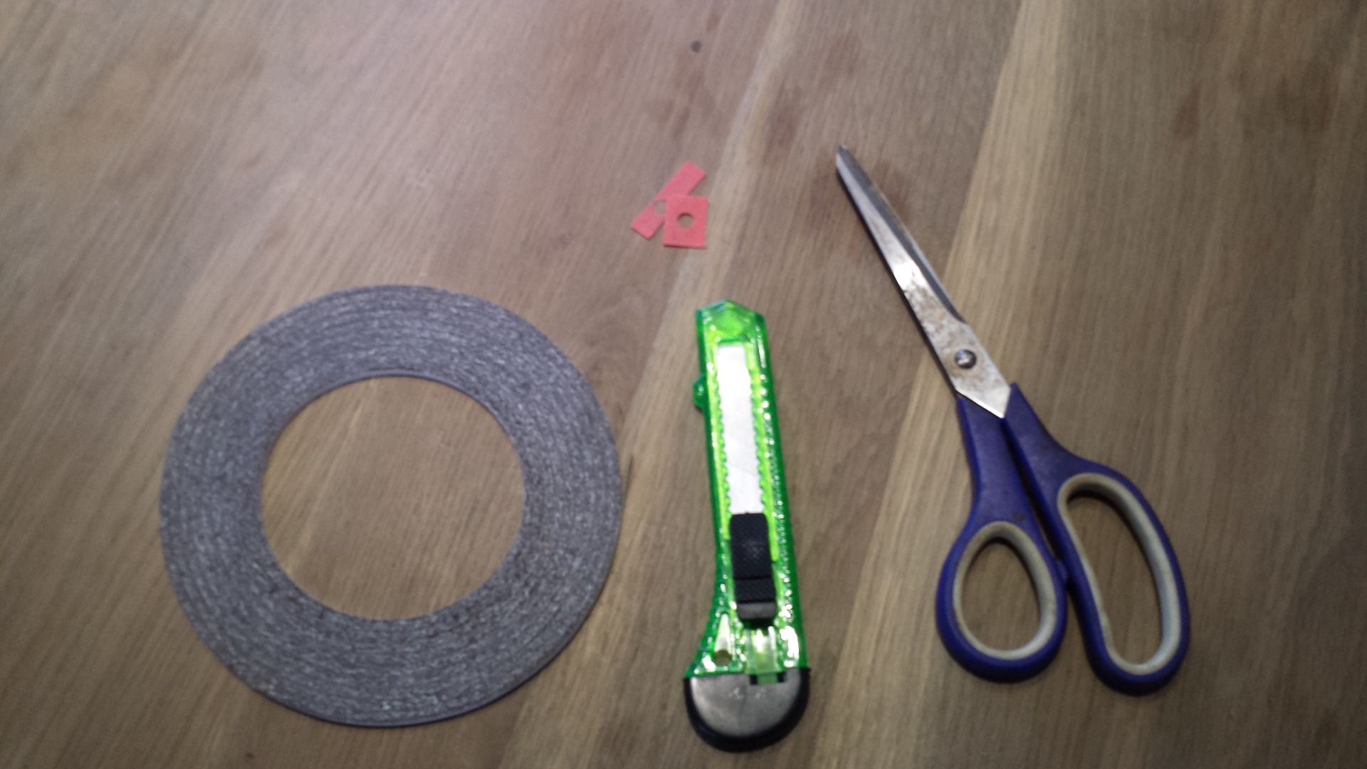

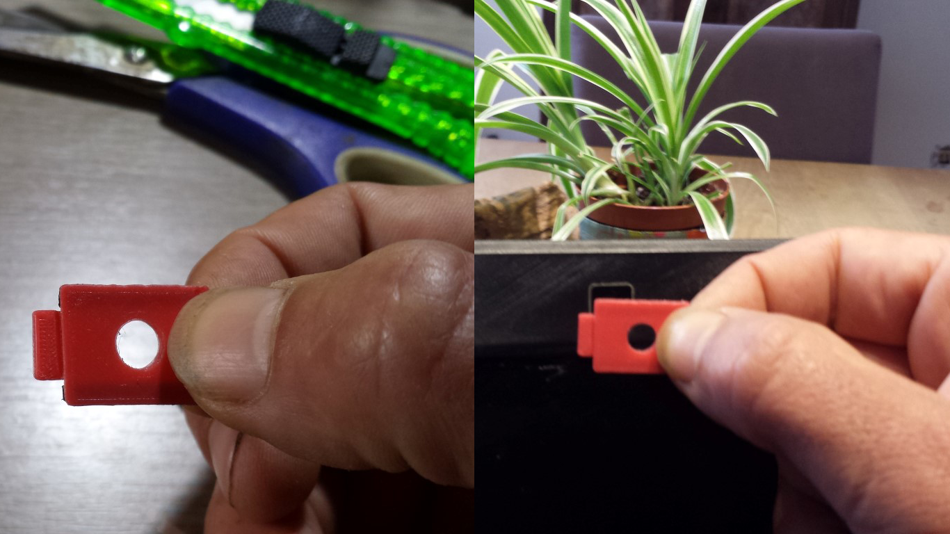

You only need thin double sided tape (I'm using double sided tape that I have for repairing smartphone/tablet touch screens) and a crafts knife or scissors.

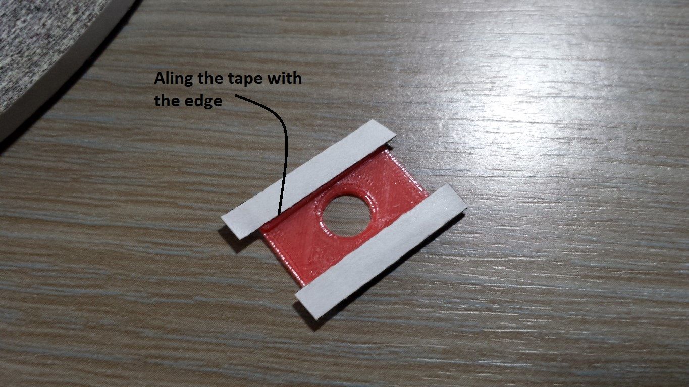

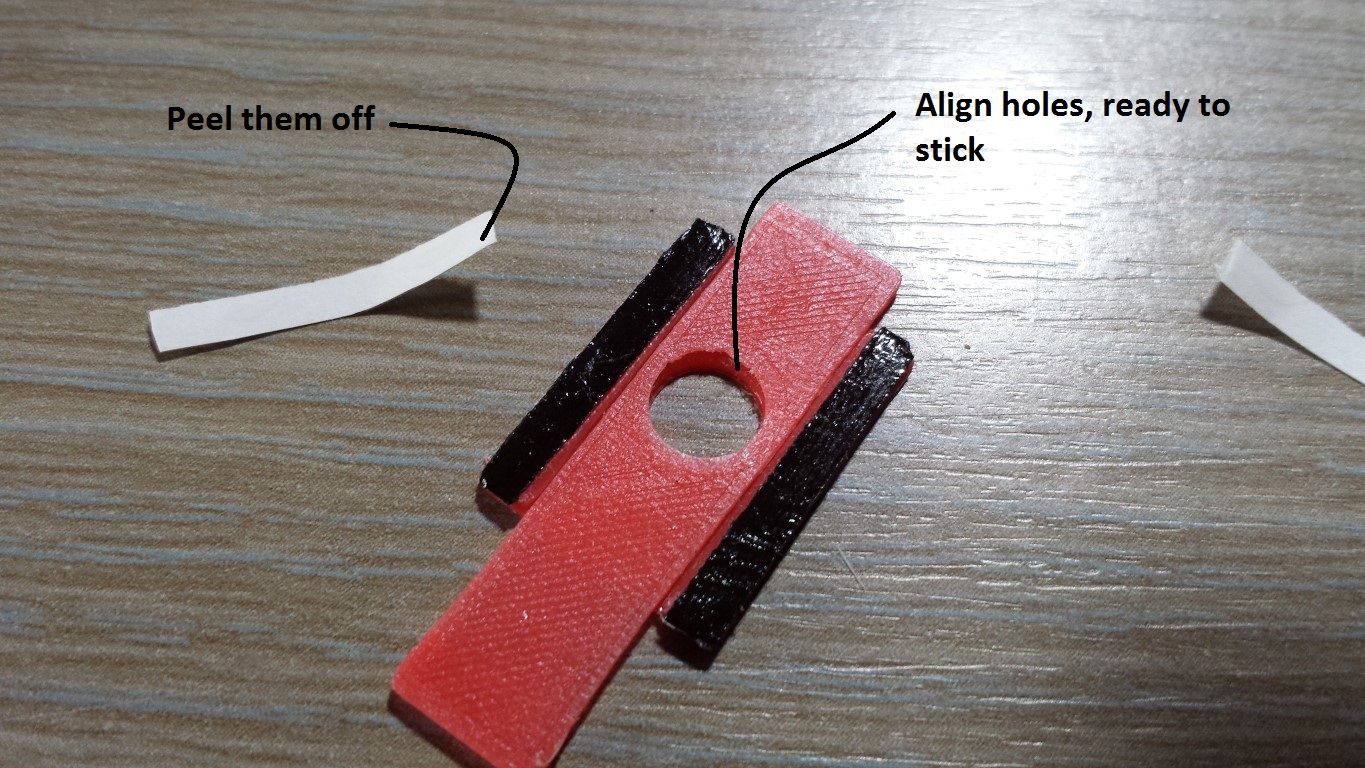

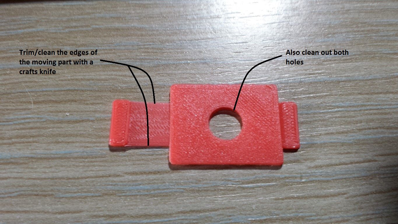

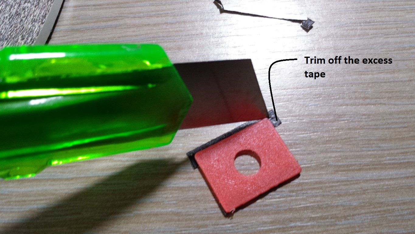

Before adding double sided tape you need to pre fit the pieces on a flat surface. Because the first layer is (most of the times) slightly wider you need to trim the edges of the parts. I scraped the edges with a crafts knife but sandpaper is fine too. I recommend using the same double sided tape as I used because it is really thin and it sticks extremely well.
