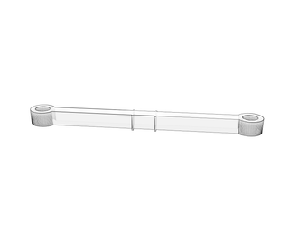

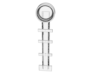

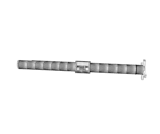

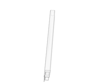

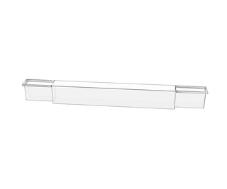

Step 1: Printing the Parts
You will need to print the follow parts in PLA

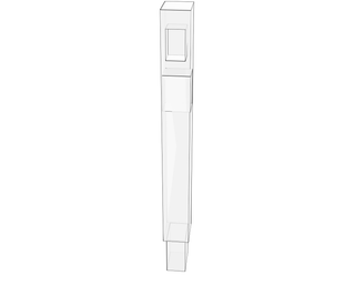

1- Base Right (the base piece with two part on the side)
1 -Base Left (with one part on the side)

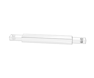

2-Base Beam
1- Upper Cross Beam
2- V Beam
2- D Beam

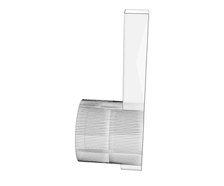

1- Lever

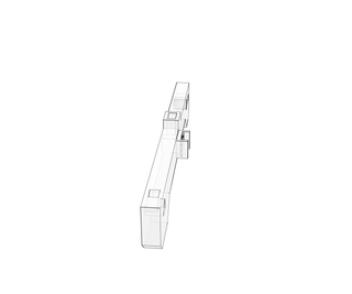

1- Arm

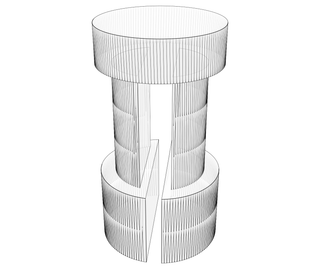

1- Arm Lock
1- Cap
4- Pegs
2-E holder
Using NinjaFlex you need to print
1-Elastic
Note that there are some support for better print on some the pieces, this will need to be removed:
Supports are as followed:
Arm Lock have four rectangle pieces at one end that need to be removed
Arm have supports along the front below baskets that need to be removed

1) Locate the two holes on the Top of both the Beam Right and Left pieces.
2) Insert one of the V beam pieces into the hole at the middle of the top of the Base Left. Note: that one of the holes in the V beam doesn't go thought the beam should be facing forward or towards the second hone found the base left piece.
3) Inset the D beam into the forward facing hold in the V beam and into second hole found in the top of the base
4) Repeat with Right Beam

2- Base beams
Arm Lock
Upper Cross Beam
1) Insert the 2 base beam from the inside of Base Left thought the hole found on the side near the front and back

3) Insert, from the inside, Arm lock's end without the slit in the round hole at the back of Base Left.

Lever
Cap
1) Lever goes onto the right side of the Catapult onto the Arm lock. Make sure that Handle part is next to the base piece, so that the cache can lock and hold the Arm in the load position. The lever handle should also be up towards the top of the Base piece.

Arm
2- E holders
1) Get one of the E holders and slip onto one of the end loops on the elastic. It might take a bit of work to get the E-holder onto the elastic.
2) Push the other end of the Elastic, from the outside, thought the rectangle hole on the side of Base left.
3) Push the Elastic thought the rectangle hole in the side of the Arm piece.
Note: The basket part of the arm should be face upwards
4) Push the Elastic thought the Base Right, from inside out.
Note: Make should that the basket part arm is behind Upper Cross Beam before moving on to the next step
