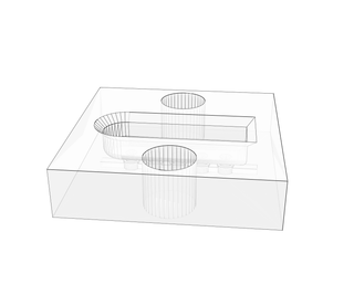

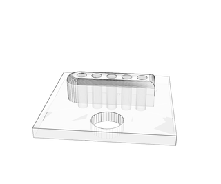

I like to make some quick technical drawing before modeling something, just to get an idea what dimensions will work, if during modeling something isn’t as good as I thought I just can change it.
I used Solidworks to do 3D modeling, but I am sure that it can be done using any CAD program like Autodesk 123D, Tinkercad, AutoCAD, Design spark, FreeCAD and probably many others. I made two models – in the “socket” one I changed the dimensions to be 0.25mm bigger than the “plug” one so we can get around 0.5mm overall space to let the plug move a bit. So it’s worth to remember that socket must be a little bigger in order to let the plug to connect.
Looking at our criteria there is one thing that we forgot about. We have to make it one way. It means that we can connect the plug only one direction so we can avoid shorts, and inverted polarity that can cause damage our circuit connected to the socket. I achieved that by making one side of the connector rounded. Now we can avoid potential shorting the circuit or reversing the polarity.
My version is meant to be under a casing, so the plate is used to glue the connector to the case. The connector is 5mm long, so if the case shell is 1mm thick i have only 4mm outside the case. The socket is designed to be 4mm deep regarding the case shell thickness. Since this is parametric model, I am able to adopt it to any casing I will be using.
I made a groove at the back of the moving connectors (in the socket one) so we can place there something like rubber or foam to allow connectors move to achieve better contact. I hope that will give them some spring-like action ant they will press against the contact of the plug.
There is place for wires also, after soldered to connectors they can be glued inside the guide holes.
The models have been prepared for 3D printing, they are "watertight" and checked with netfabb software. They should print nice and without problems ;)

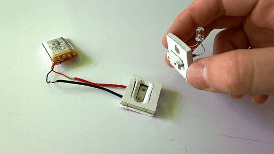

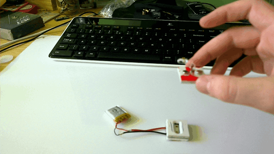

So, I made a working prototype out of foam board, it was a bit difficult to cut out, but finally it works!
There are only two connectors, because I just wanted to check if it will work as it should, just to prove that this design is working. The Foam board prototype have almost the same dimensions as the 3D printed one. If you want an separate instructable on how to make this type of connector but by hands tell me in the comments!
