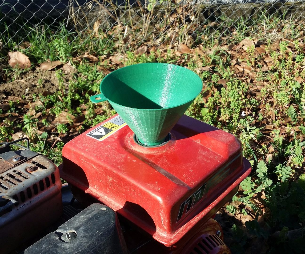

Step 17: Prints Made
As you can see from the pictures, the prints are already quality but to achieve it I have been almost a month calibrating everything and printing several times the printer pieces.
