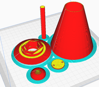

Step 1: 3d Print the Parts
I printed them with a .5mm line thickness and a .24mm line height. You can use other values based on the quality you want. The 'UFO' and the 'HAT' needs support, but the others don't.
