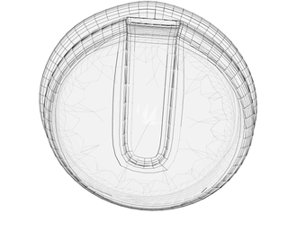

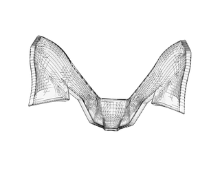

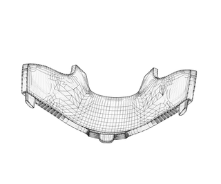

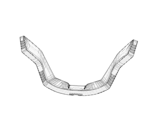

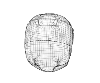

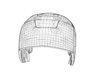

Step 3: Printing

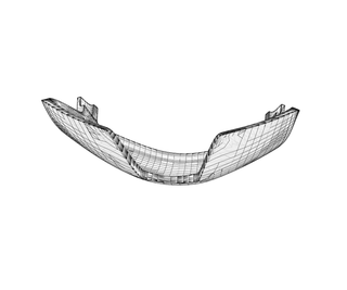

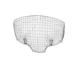

The pictures shown above are the pieces which make up the shell of the Helmet. I would recommend printing out the smaller pieces (ear piece and yellow jaw piece) first, therefore you understand how your 3D printer works.
Before you print you must add supports to the pieces so they can print properly. Use mesh mixer and generate supports, decide which ones are best for your printer and which ones are unnecessary.
Also It does not matter which color of filament you use, we are going to paint it with acrylic paint once they are printed.
I would also recommend printing in PLA because it is the easiest filament to paint on with Acrylic Paints.
* Adults should increase the size of each piece proportionally because it may be hard to wear in its original size.
*The STL Files were borrowed from and credited to Cairon from Thingiverse
