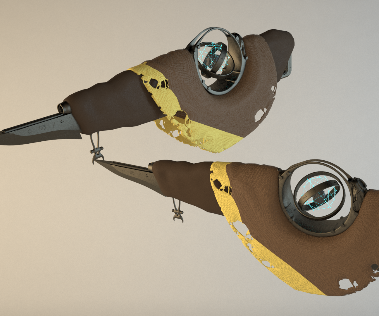

Inspired by the 2016 space contest, and because my space weapon from Destiny (Touch of Malice) was rejected, I leaned back and thought about what doing else. After a while I got an Idea – a 3d printed Version of Mars.
