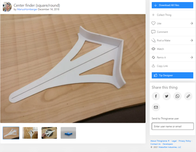

Step 2: Center Finder for Squares and Circles...
This is a very interesting item to print and have handy.... As the name suggest, this tool helps us to find the centre point of a circle or a square... There is a cutout in the tool... Which let us draw lines with a sharpy or pencils...
There is a version available on thingiverse... But I created my own model to reduce some material... And to change the shape a bit... It's true that my model isn't long enough as the original one. But for my needs... It's well suitable...
Like previous project... I also modeled this in fusion 360... With some basic CAD knowledge...
And then printed the file with PLA filament with 100% infill...
The files of this project will also be available down here... https://www.thingiverse.com/thing:3283699

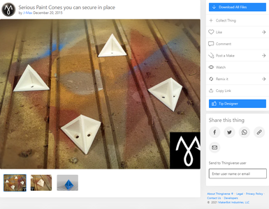

Step 5: 6 Cones ^ for Support Objects While Painting...
many times when we try to paint something, the paint drips and the object sticks with the surface under.
So I made these support cones... this is a set of 6 cones... I got the inspiration from a project from thingiverse...
the cones are printed in 100% infill and I also added holes...
The cones are reusable and they are one of the useful items I have printed so far...
The Thingiverse file link - https://www.thingiverse.com/thing:1213402

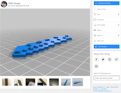

Step 8: Fillet Radius Gauge (Download From Thingiverse)
This fillet gauge or radius gauge is the simple tool to measure the fillet size, to recreate any existing product or item in 3d. We all know that the measurement of the fillet size is very hard.. so I printed this tool, to easily measure that.
I will link the thingiverse item link here - https://www.thingiverse.com/thing:1184315
