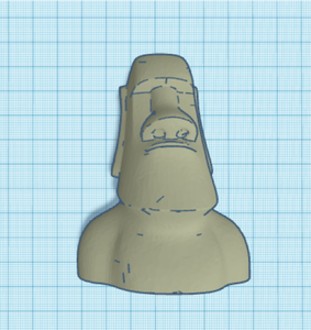

  • First, we need to find a good 3d model,
  • I choose Moai,
  • as this was a simple design,
  • not many fine details,
  • Symmetrical
  • I got mine on Thingiverse

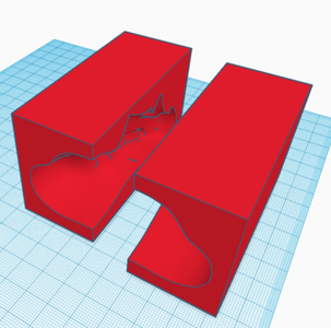

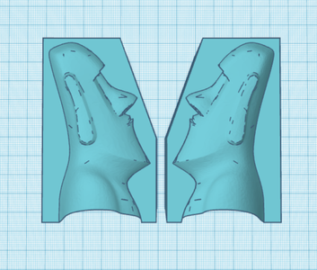

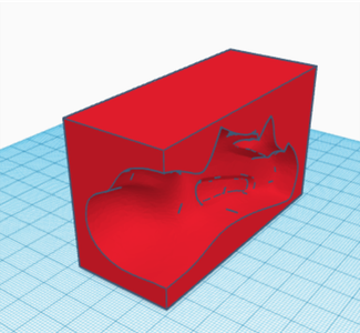

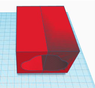

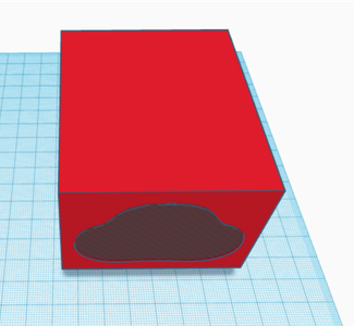

  • To Make the mold
  • Import the STL file in tinkercad
  • Convert it from solid to a hole
  • Add a Box and adjust the dimensions to be at least 3 to 5 mm larger than the actual stl model
  • Group them and then cut this into half
  • Duplicate the model and then mirror it
  • Turn them to lay flat as shown
  • I have trimmed the mold edges to reduce time and PLA consumption
