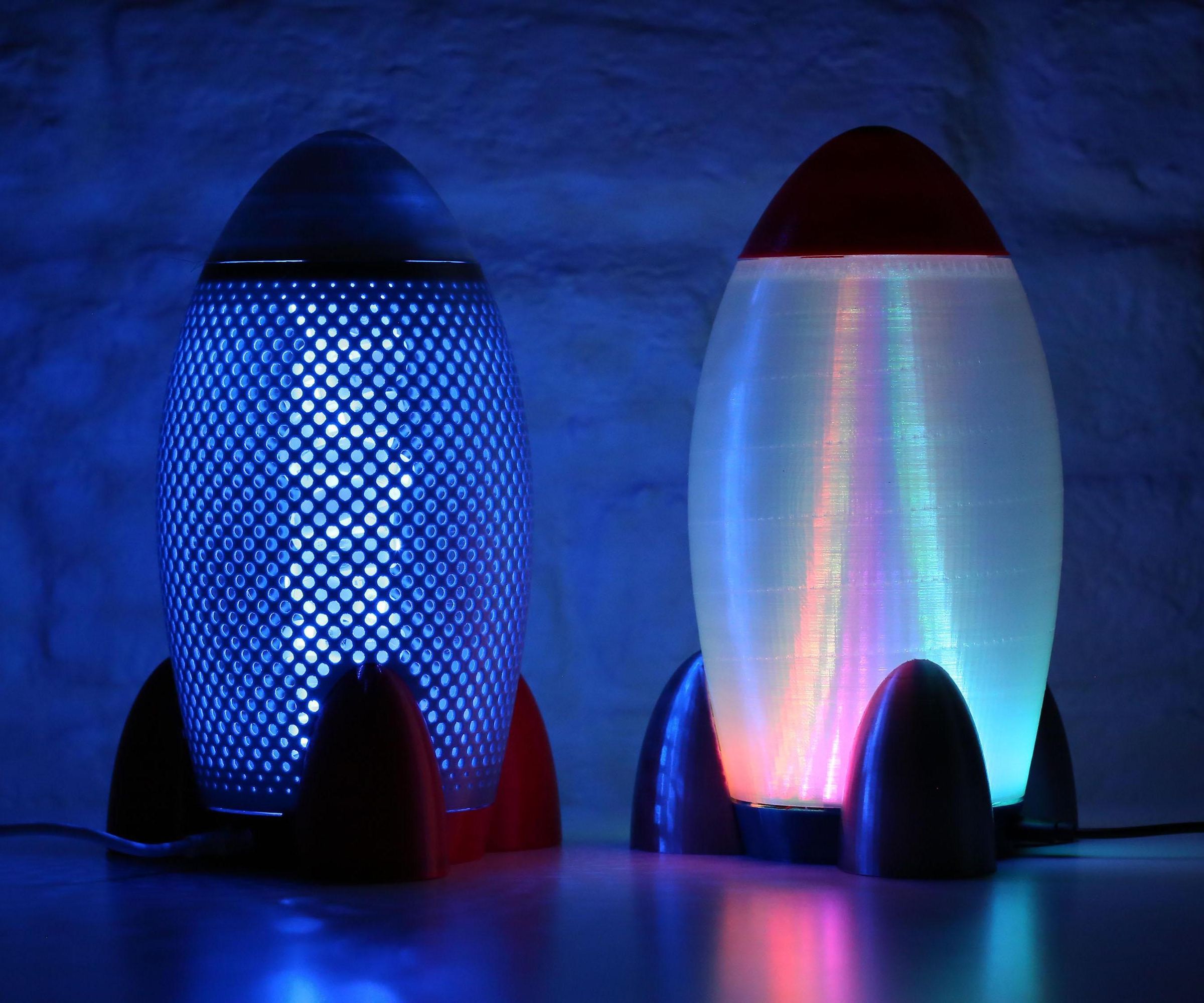

Step 3: Choose Your Design
Then you can choose the design of the body from:
  • solid
  • net
  • stars
then print it on a 3D printer, and put everything together.

You will need a DC connector, a DC 5V-12V power adapter, and an RBG LED strip 5V-12V. Because our lamp has no visible button, we have added a Smart socket to this version, which can be controlled by the phone again, and you can remotely turn off the lamp when the child falls asleep without waking him up. In this case, we used a Smart socket from FIBARO. The advantage is also the possibility of connecting this socket to Amazon Alexa if you have this system at home.
  1. You can install the DC connector in our Base_DC.stl, which has a circular hole prepared for commonly sold DC connectors.
  2. If it is larger than the width of the walls in the base, you can cut the plastic with a knife.
  3. Then we recommend fixing it with a hot glue gun.
  4. You simply solder the DC connector to the LED strip or use wago connectors as you can see in the video Advanced Level
  5. Then pass the LED strip through the hole in the tower and fix it.
