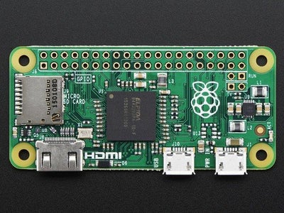

  1. Raspberry Pi Zero W (~$10 at Micro Center)

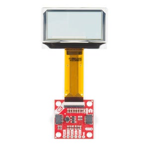

  5. Clear OLED display. (This is what I used)

Step 8: Setting Up the OLED Display
Enabling I2C
Finally, we have made it to one the coolest parts about the smart glasses, the transparent OLED. This is where we are able to display information to the user such as, time, temperature, and just general info. As I said previously, this display will work via I2C and the luma.core python library. By default, I2C isn't enabled, so we must enable it. Go to the same place you enabled the camera module and enable I2C then reboot.
Wire It!
To connect up the wires me must solder them from the driver to the RaspberryPi. I recommend a soldering temperature of 725°F/385°C. Don't forget to power off your RaspberryPi and disconnect any peripherals. Here are the connections.
OLED---RaspberryPI
GND-GND
3v3-3v3
SDA-GPIO_2(SDA)
SCL-GPIO3_(SCL)

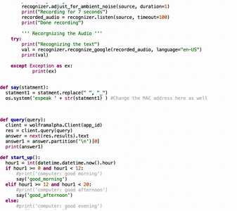

def listen():
    recognizer = sr.Recognizer()
    ''' recording the sound '''
    with sr.Microphone() as source:
        print("Adjusting noise ")
        recognizer.adjust_for_ambient_noise(source, duration=1)
        print("Recording for 7 seconds")
        recorded_audio = recognizer.listen(source, timeout=100)
        print("Done recording")
        ''' Recorgnizing the Audio '''
    try:
        print("Recognizing the text")
        val = recognizer.recognize_google(recorded_audio, language="en-US")
        print(val)
    except Exception as ex:
            print(ex)
def say(statment):
  statment1 = statment.replace(" ", "_")
  os.system('espeak ' + str(statment1) ) #Change the MAC address here as well
def query(query):
  client = wolframalpha.Client(app_id)
  res = client.query(query)
  answer = next(res.results).text
  answer1 = answer.partition('\n')[0]
  print(answer1)
def start_up():
  hour1 = int(datetime.datetime.now().hour)
  if hour1 >= 0 and hour1 < 12:
      #print('computer: good morning')
      say('good_morning')
  elif hour1 >= 12 and hour1 < 20:
      #print('computer: good afternoon')
      say('good_afternoon')
  else:
      #print('computer: good evening')
      say('good_evening')
  say('how may i help you')

def util(func1):
  cdt = datetime.datetime.now()
  min1 = str(cdt.minute)
  hour = str(cdt.hour)
  with canvas(device) as draw:
    draw.text((0, 0), hour, fill = "blue")
    draw.text((11, 0),":", fill = "blue")
    draw.text((15, 0), min1, fill = "blue")
    draw.text((0, 0), "___________", fill = "yellow")
    draw.text((0, 9), date, fill = "white")
    draw.text((33, 0), str2, fill = "white")
    draw.text((0, 64), func1, fill = "white")
########Section_4#############
while i < 3:
        say("Recording")
        say("Done Recording")
    try:
        val = ("Sorry I could not pick up what you said")
        print(val)
            print(ex)
    if val=="Sorry I could not pick up what you said":
        print("Sorry I could not pick up what you said")
        say('Sorry I could not pick up what you said')
        i = int(0)
    if val=="news":
        news_url="https://news.google.com/news/rss"
        Client=urlopen(news_url)
        xml_page=Client.read()
        Client.close()
        soup_page=soup(xml_page,"xml")
        news_list=soup_page.findAll("item")
        # Print news title, url and publish date
        r = 0
        for news in news_list:
          print(news.title.text + "\n")
          say(news.title.text)
          #print(news.link.text)
          #print(news.pubDate.text)
          #print("-"*60)
          r += 1
          time.sleep(1)
          i = int(0)
          if r == 3:
            i = int(0)
            break
        time.sleep(3)
        i = int(0)
    if val == "exit program":
        os.system('pkill -f main.py')
        del val
    if val == "SMS":
        del val
        say('who would you like to send a text to?')
        try:
         print(val)
            print(ex)
        dude = str(val)
        del val
        say('what would you like to say')
        try:
         print(val)
            print(ex)
        msg_to_send = str(val)
        del val
        send_sms(dude, msg_to_send)
        time.sleep(3)
        i = int(0)
    if val == "pause for one minute":
        say("pauseing for one minute")
        time.sleep(61)
    if val == "pause for 2 minutes":
        say("pauseing for two minutes")
        time.sleep(122)
    if val == "shutdown":
        say("shutdown")
        os.system("sudo shutdown now")
    if val == "time":
        cdt1 = datetime.datetime.now()
        h = cdt1.hour
        m = cdt1.minute
        print(str(h) + ':' + str(m))
        say(str(h))
        say(str(m))
        del val
        time.sleep(3)
        i = int(0)
    if val == "picture":
        #camera = PiCamera()
        x = x+1
        globals()['image%s' % x] = 'image%s' % x
        print('image%s' % x)
        camera.capture('/home/pi/Desktop/' + 'image%s' % x + '.jpg')
        print('image saved to desktop')
        say('image saved to desktop')
        time.sleep(3)
        i = int(0)
    if val == "play belever":
        os.system('aplay /home/pi/Desktop/Belever.wav')
    if val == "play happy":
        os.system('aplay /home/pi/Desktop/Happy.wav')
    if val == "play happier":
        os.system('aplay /home/pi/Desktop/Happier.wav')
    if val == "play pop music":
        os.system('aplay /home/pi/Desktop/Pop_music.wav')
    if val == "video":
        v = v+1
        globals()['video%s' % v] = 'video%s' % v
        print('video%s' % v)
        say('recording for 15 seconds')
        camera.start_recording('/home/pi/Desktop/' + 'video%s' % v + '.h264')
        sleep(16)
        camera.stop_recording()
        print('video saved to desktop')
        say('video save to desktop')
        time.sleep(1)
        i = int(0)
#############section_5######################
    try:
        client1 = wolframalpha.Client(app_id)
        res1 = client1.query(val)
        answer1 = next(res1.results).text
        answer2 = answer1.partition('\n')[0]
        for i in bad_chars:
          answer2 =  answer2.replace(i, '')
        print(answer2)
        say(answer2)
        i = int(0)
    except:
        try:
          wiki = wikipedia.summary(val, sentences = 1)
          #print(wikipedia.summary(val, sentences = 1))
          print(wiki)
          #say(wikipedia.summary(val, sentences = 1))
          say(wiki)
          i = int(0)
        except:
          print('')
    del val
    #del val
################THE_END##########################
Step 10: What the Code Does
This part is what the code does so if you want to change anything, you'll know where to find it:
#1 Importing the Libraries
These are the libraries that we installed earlier in the tutorial, so all you have to do is copy pasta.
#2 AppIDs and Authorization Tokens
Here are all of our App_IDs and account tokens as well as some other variables. Replace the contact numbers and names with people you would like to send SMS to. Put all of your specific appIDs and auth tokens that we got from step three into their indicated places.
#3 Functions
In this section, we define a lot of tasks for the display that would be rather tedious to type out each time. This is also where the start-up sequence is defined and initiated.
#4 While Loop and If Statements
This is the part of the code that infinitely loops until you end it with the keyword, 'exit program'. Taking a deeper look into this section we see the glasses can tell you the news, send SMS, tell time, take pictures, take videos, and play music based on the trigger words inside of the if-statement condition.
#5 Catch-All
If you didn't say any of the trigger words then the program will search whatever you said on Wolfram, but if that fails it will search Wikipedia and return a short summary.

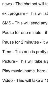

Step 11: How to Use the Code
Before trying to execute the code make sure your wireless headphones are connected. If all goes well the display should turn on and the chatbot will ask what you would like for it to do. It will listen for your response whenever the three dots at the bottom of the screen are present. Below is a full list of the commands and what they will do. When you are done just say, 'exit program' then flip the power switch. It's that simple!
The default commands are:
news - The chatbot will tell you the top three headlines from Google News.
exit program - This will stop the script and then all you have to do is flip the switch.
SMS - This will send any message to anyone you tell it to.
Pause for one minute - it will pause for one minute
Pause for 2 minutes - it will pause for 2 minutes
Time - This one is pretty self-explanatory and is a little more descriptive than the clock on the screen.
Picture - This will take a picture and save it to the raspberry pi desktop.
Play music_name_here- This will play a song on the desktop of the raspberry pi named music_name_here
Video - This will take a 15-sec video then save it to the desktop
