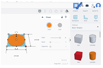

Step 5: Create the Clock Face

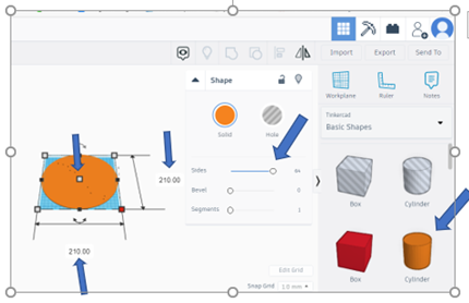

Use the solid cylinder as your base for the clock. Drag the image onto the work plane and resize it to your specifications. I used 3.2mm for the thickness of the clock and 190mm for the diameter. You can adjust the size by changing the number in the spots below after clicking the white boxes on the corners or center of the object. I also adjusted the sides to 64 to make the circle smother.

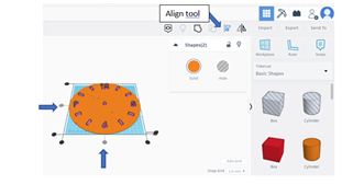

Step 6: Import Images for Clock Face
After importing adjust the size to suite your clock face. I went with 18mm diameter and 1.6mm thick. Then you drag the image on top of the cylinder you previously created. Don’t worry about lining them up perfectly by hand, tinkercad has a took to help with this. You drag a box around both objects and then click the align tool. Then use the dots around the objects to line them up perfectly.
Step 7: Group Objects
Drag a box around both objects and then click the Group objects button to combine both pieces into 1.

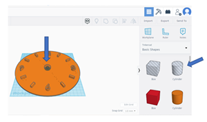

Step 10: Make a Hole
To do this you simply drag the clear cylinder onto the clock face and place near the middle. You need to adjust the size of the new cylinder the size the clock will go into, approximately 11.5mm.
**Remember you don’t have to be exact on centering the cylinder because tinkercad will do the hard part for you by aligning it perfectly in the center. Just repeat the steps above to align it.

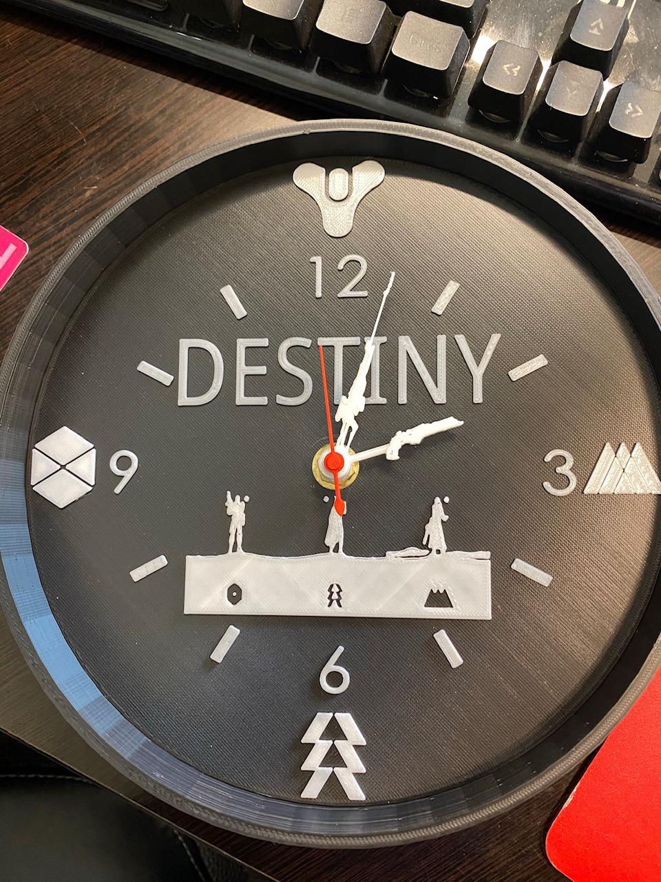

Step 16: Putting It All Together
Add a small amount of super glue or model clue to the inside lip of the bezel. Fit clock face into bezel and press to let glue cure.
Add clock parts to new clock face. Follow directions on package to install the clock.
Admire and smile at your work....don't forget to add batteries to clock!!1
Step 17: Extra Credit
I wanted to keep my clock in the theme of the video game I play so I designed the clock hands to be weapons from the game. Using the same steps outlined above, I created a hand cannon hour hand and a sniper rifle minute hand. I used the new hands in place of the ones that came with the clock. The .STL files are included with the others.
